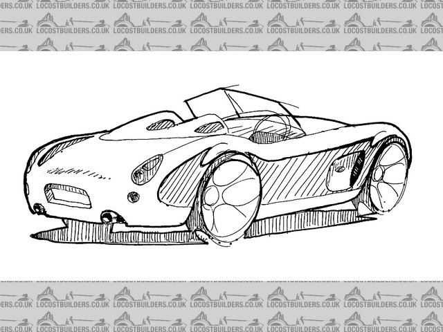

Work has been started on the plug but all I have at the moment is this arty farty impression of what it will be like.
It's not a Cobra before anyone suggests otherwise it pre dates those by a few years.
Any thoughts good or bad fire away?

looks just fine but what about weather gear and getting in, will it be like a beachbuggy...clamber over and fall in?
good headlights to use would be the new mini's
How many wipers is that going to use, lookes like 3-4?

Prefer the Fury/Phoenix styling myself and that looks a little too Cobra-esque to me.
I'm sure there will be fans though.

Looks Ok to me.
Porsche speedster like with the front wings and screen.

What is the back like?
The big question will be the exhaust.
IMO this type of bodykit, that just sits over a standard chassis will be one of the only ways to get a seven style car through the new IVA.
Maybe there will be other work arounds, but people will be looking for a simple, not to ugly option and something like this might be looked at.
I think these type of body kits will get very popular unless another option presents itself that aviods the IVA problem.
I think its quite nice.
Maybe not as modern as some, but then the 7 isn;t exatly a cutting edge design so might suit the target market.

The screen in the sketch looks a bit too low - maybe either a "proper" screen or a lip would be better?
As mentioned, the back end is all-important too... let us have a look!

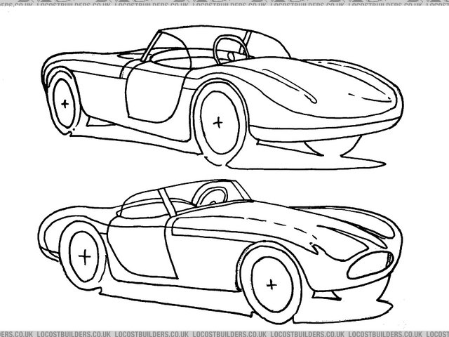

My first response was to request more details and preferably images in order to formulate any meaningful / useful opinion, but in my wanderings I
found some older posts quite by accident - are you talking about the 581? The original pics seem pretty good underlays on which to base sketches -
please find attached some quick traces; excuse the quality, but currently without functioning scanner so photo'ed, uploaded and bounced down to
b+w which can be bit harsh.
  tracing of Triton 581 photos
bigger version in my archive - btw where do I report a fault? Forum doesn't like '+' in image filename...
Anyway, comments... first thought is that it's a neat looking thing and to these eyes at least more reminiscent of a C-Type Jag than a Cobra
which is no bad thing; give a vertically oriented grille and the resemblance would be even clearer.

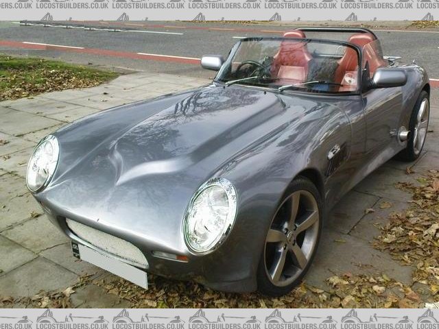

Below is a Phoenix (? Stylus? ) with new Mini lights - the workmanship is top notch but it doesn't look like part of the original design, in this
case as if the front end of the wing has been sliced off and capped with the new lights.

Oh dear - these were done with one eye on the GP without having seen your post, anyway...
Rear 3/4 - I assume some changes will be made to the tail just to incorporate stuff like the numberplate etc, so I've deepened and reprofiled it
slightly - it's a bit more squared off at the bottom: think 300 SLR. Though I've no idea of the scaling, I've sketched in the PT
Cruiser taillights plus an ancillary light. The seat fairings are not just styling: if the 581's rear deck needs to be raised to clear the Locost
chassis then it could be concealed within this feature. Similarly there is an aerodynamic justification for the sidevent, but from a styling
perspective it also adds interest to the flanks - which might help if there aren't any doors, etc. and I think wheelarch extensions have already
been mentioned...

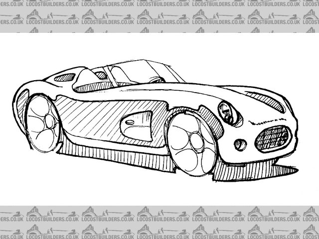

  Triton 581 sketch rr 3-4
Front 3/4 - in addition to the above, grille and front air dam deepened - which might give it a hint of the short nose D-Type about it. Post '06
Mini headlights inserted (again no idea of scale) plus driving lights, note that the Mini lights are slightly recessed as I think the surfacing is
unlikely to match, and this kind of feature is probably the best way to try to integrate them in that eventuality.
  Triton 581 sketch fr3-4
