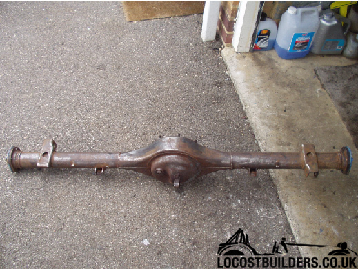

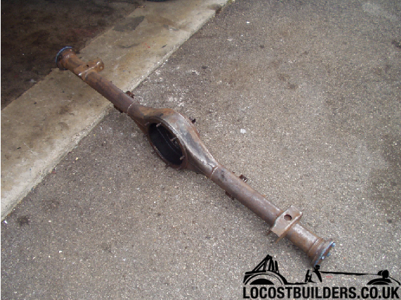

It's an English mike, or at least that's what I've been led to believe after numerous queries on here. The diff comes out forwards
as opposed to having a plate that is removed on the rear. I've got a couple of piccies in my archive
here and here

So, if yours IS 52 inches AND an English (front loader) diff then my guess is that it is a rare 1300/early 1600 Capri unit.
That is not a bad thing! As it will take a cheaper and easy to find LSD unit than a Cortina One.
Which is probably why the guy fitted it to his escort.
I wonder? was this RS2000 a standard looking car, or did it have wider arches?
HOL
| posted on 18/5/09 at 12:27 PM |
Just looked at your picks and its deffo not an RS2000 axle as it has anti roll bar and not anti-tramp mounting brackets.
If 52, my guess is still the same = Capri 1300/1600.
Worth keeping imho.
