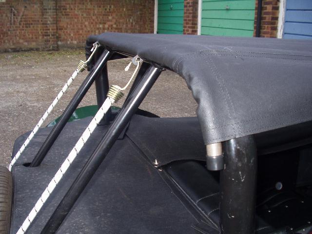

Back Tube + Giant Aerolastic

The vinyl came from 'woolies' , I think it was heavier and for hoods so it does not stretch too much in the sun.
I have no industrial sewing machine , so all those soft bits on my car I cut and where possible glued with evostik so I could just take to a guy up
the road who then only had to sew it.
If you have Westfield or Caterham screen another easier way would be to get hold of an old damaged hood ,and use the front piece for the top
windscreen fitting and curve, mine could definitely have been better in this area.
I have to give my old man credit for the giant elastic idea, it looks a bit basic but its very quick and easy to attach and gives the hood panel a
bit of tension.
