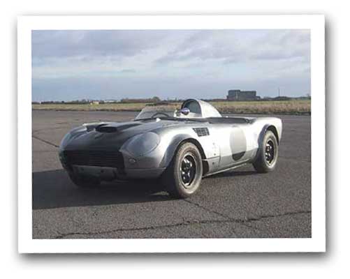

Yep, the weight saving is the thing, but also I want the car look different as well.
this look would be nice
I like that idea a lot. Since I'll be selling my Indy soon and my elise is already up for sale, I'm looking for the next project to start
and was thinking about doing something similar to an MG midget, only using an R1 engine as well, like this one that Lynx AE did, but with the aero
look.
I have to say I do like the MGF version though, and I imagine there'd be a whole load less rust to cope with as well...
