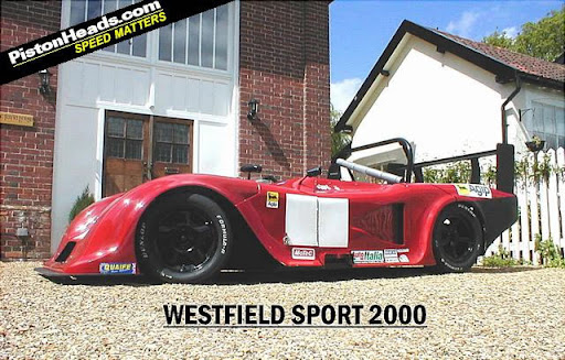

A number of people had asked about this so I thought I would start a thread. For those that don't know this is the car I am talking about;
I first asked about the car in this thread from 2006,
linky and this is what Matt from Procomp said;
“Hi this car now belongs to 7 in a fancy suit indeed a member on here the car was originally a prototype built by westfield and raced for a short
time in the 750mc by Jack Dalmas and then sold to Tom Laffey who used it for a short time the moulds were bought by us Procomp . The car was then sold
by Tom to some one in Scotland and after a lack of time to do anything with the moulds were also sold by us to the same person i believe. After that
it seemed to disappear for the next 10-15 years but then turned up again with the vx fitted as it originally had a xflow. It changed hands a few times
and then ended up with it's present owner in Ireland and the moulds now back with us Procomp . The plan is to use the moulds to produce a new
body for our new car in 2007 although will be quite different to what it is now. the existing moulds were only ever prototype and are now in need of
repair . The existing body would not fit over a 7 type chassis as it is more of a front engine rear wheel drive mid seated driver with the engine sat
on top of the front axle line”

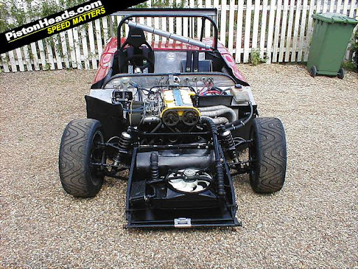

"The existing body would not fit over a 7 type chassis as it is more of a front engine rear wheel drive mid seated driver with the engine sat
In the picture with the bonnet off, we can see that this is NOT the case, the chassis member joining the two upper spring mountings can be clearly
seen, and unless the example shown has been modified from the original referred to, the engine is behind the front axle line and not over it.

" the chassis member joining the two upper spring mountings can be clearly seen, and unless the example shown has been modified from the
original referred to, the engine is behind the front axle line and not over it. "
Notice that I didn't say that the bodywork would fit over a standard 7 chassis (whatever that is supposed to be), what I was drawing attention
to was the fact that the engine (in the picture I was referring to) was behind the front axle and not over it.
Does it matter? Of course it bloody matters. A spaceframe is relatively straightforward to design if the spring mountings can be linked with a
straight tube as in the photo. If not, if there is an engine in the way, then it's quite a bit more tricky, so much so that I can't
offhand think of a spaceframe car that does have the engine over the axle.

One thing I had thought about doing was borrowing my mates locost and seeing how close the bodywork is. If it could be made to work that would be a
cool rebody for a 7.

Looks to me (difficult to tell with the pictures, why does nobody ever take a picture of a car side on) that if the bonnet or the front end, rather,
was lengthened a bit you would be ok for most narrow 7s, Locosts etc. Sierra based cars a bit trickier, maybe
[Edited on 23/11/09 by mr henderson]

Hi.
If anyone would like to know the full details about the car or the bodywork etc you can contact me. But i assume Liam will know all that is to know
also. The car that is pictured and what was originally built are two very different things as many mods have taken place on the chassis and the
moulds.
Hope all is going well with your project Liam. It's about time that the project was brought back to life.
Cheers Matt

The mould as they are now are nothing like the car in the picture. They where altered to make it rear engined rather than a front engined setup.
chances of it easily fitting over a Locost chassis are not viable without seriously re modifying to an extent that it would be easier to start from
scratch.
What it really needs is a rear tranverese setup.
Cheers Matt

Matt is right the red car is a lot shorter in the arse than the moulds I bought. They're actually coming out of storage tonight so i will take
some photos and measurements. could end up with a middy yet
