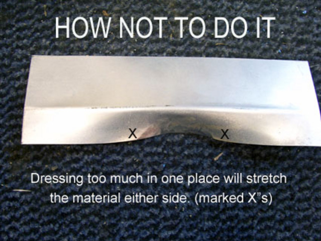

The shrinking machines used by professionals (like Trev) have a deep throat and allow you to shrink well into the sheet.
They are powered and the dies nip the sheet many times a minute.
For us Locosters another plan is needed.
I made a jig from a rolled length of pipe. It's down to what you have, so others might use wood and shape it with a sander. pic 1.
Pic 2 shows the flat sheet, 90deg fold, then pulled to shape with just the shrinker.
Pic 3 (yup, frightening isn't it? ) shows the next stage.
Clamp in the jig with the luggage strap and dress over with a rubber mallet.
Out of the jig and shrink the edge. Back in and dress. Shrink, hammer, shrink, hammer, till a rough shape is achieved.
Into the E wheel and take out the tucks, wheeling from the shrunk edge to the flat centre area and back, working round the fender.
Don't wheel into the area you want to stay flat.
(My first two ended up in the scrap bin. )
I then cut off the chewed edge the jaws had made and welded in a crescent shaped piece, wired the edges and we have pic 4.
I find shaping ally very time consuming but very satisfying. A sense of achievement and all that.
Good luck (and post pics)
Paul G

O Cory! Lesson one. There is no such thing as a failure.
Sometimes things don't turn out quite as well as we had hoped, but next time it will be better.
It's called a learning curve. Please don't give up.
Where to start? I'm asking myself the same question.
The technique is to tap the edge over to say 15deg and work along.
Go back to the start and work along again, this time to 30deg, but not as far.
Transitions should be gradual so that in no place does the edge go from 90deg to no bend at all, unlike the pic below.
I would start start with a centre line on the sheet corresponding with a centre line at the top centre of the dash former,
working outwards towards the scuttle corners, each time stopping a little shorter.
Another post to follow.
Paul G
