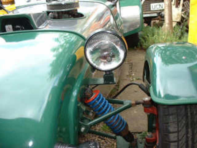

I cut and bent a piece of 20mm*40mm RHS, not to bad once it's fully welded.
See attached pic.
All the best Dan.
  headlamp trail 02

| posted on 14/5/04 at 05:14 PM |
Forgot this bit.
I used a piece of flat 5mm welded to the top chassis bar but I had to put an upstand on th reach the height for sva.
