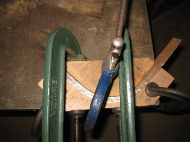

I have to say that I'm intrigued by this little problem and while you are on holiday Raz, I've been wasting some hours experimenting with
just simple tools to give a decent result. Indications are that forming curves (L section), stretching on one and shrinking on the other and then TIG
welding them together might work.
2cv
| posted on 4/9/10 at 08:43 AM |
Using marine ply as a hammerform, the first section is formed
[Edited on 4/9/10 by 2cv]

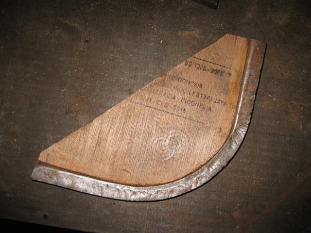

2cv
| posted on 4/9/10 at 08:47 AM |
[img]
Just planishing needed to work out the hammer marks
