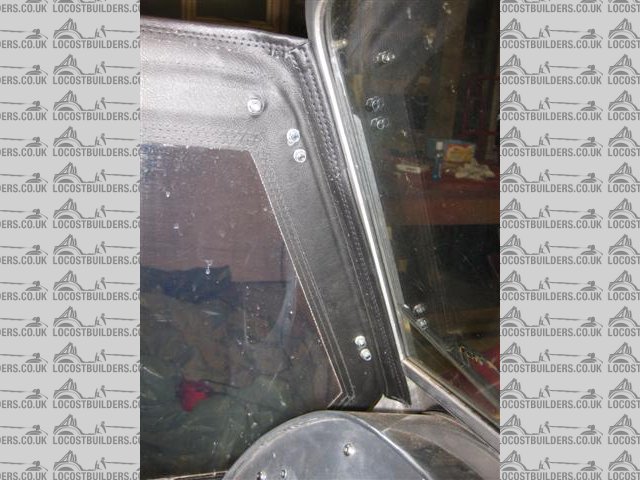

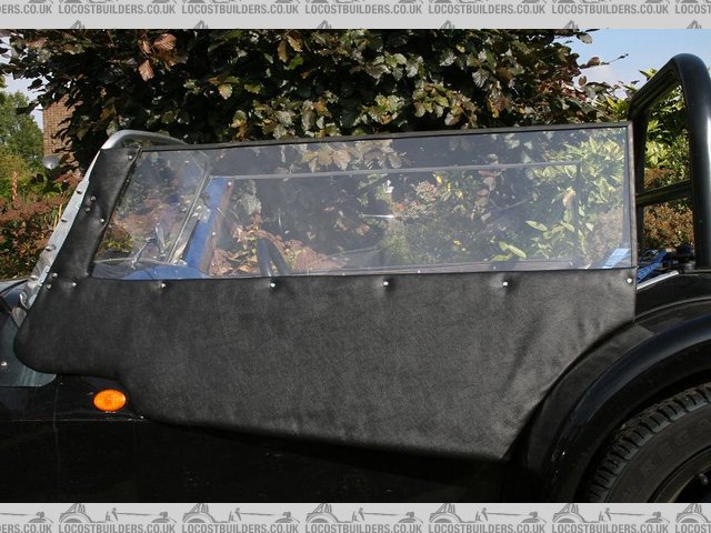

2cv
| posted on 6/9/10 at 04:35 PM |
I've seen these fasteners used
[img] Image deleted by owner[/img]
[img]
[/img]
