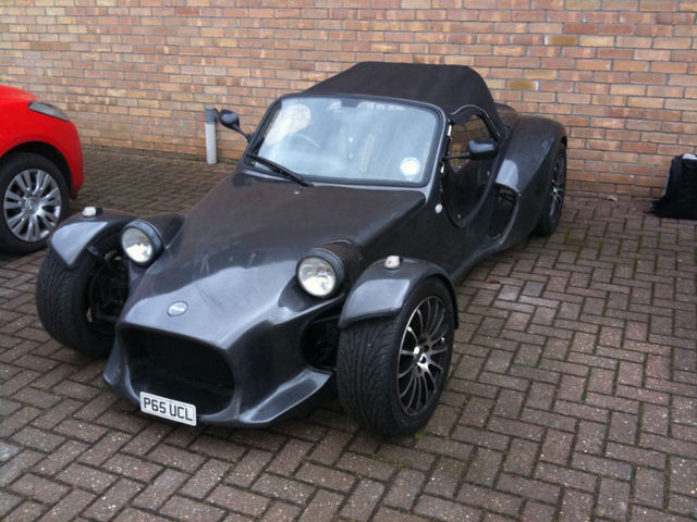

| posted on 29/9/10 at 08:31 PM |
I third Piddys idea..! I stole/borrowed the concept directly for my Mojo and it works a treat. I used much heavier fabric as I was concerned about
it 'drumming' at speed. My roof is fine for motorway speeds.
Caravan awning rail across the top of the windscreen (eBay) will give you a watertight seal across the front. Then get your choice of fabric from
Point North fabrics and crack out the sewing machine.
I used the 3M reflective piping from PointNorth to tidy up the edges and to make sure I can be seen in the dark. In daylight, it just looks like grey
piping, but when light shines on it, it is very bright and really helps with such a small dark car!
I also left the rear window out completely to stop it misting up inside on rainy days. As long as you park facing the rain then the inside stays
perfectly dry.
getting in and out with the roof fitted can be a bit of an artform, but I just unhook it from the rollbar to about halfway and fold the top over. I
can then hop in, reach up and pull the roof over, and reach behind me to do up the fixings.
Ed.

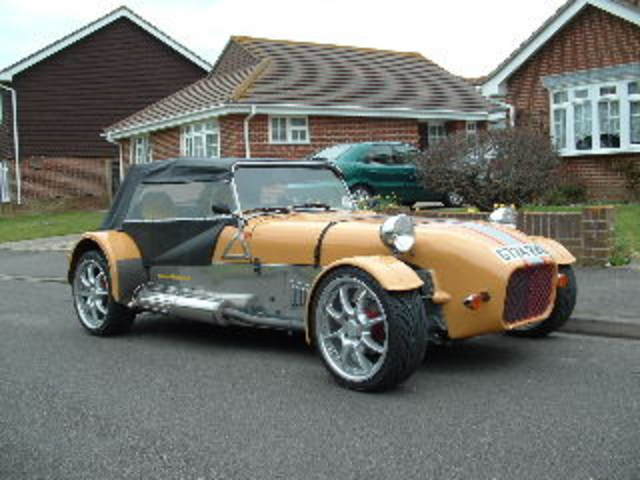

Madinventions
| posted on 29/9/10 at 08:36 PM |
  Mojo Roof Rear (in the rain!)

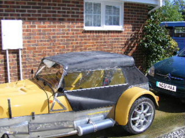

| posted on 29/9/10 at 10:50 PM |
I constructed both a hard top, and a hood. Will try to stick the pictures up.
This is the hard top, prior to being painted.
  Hard top
This is the soft top. Cheers Ray
  Hood 1
