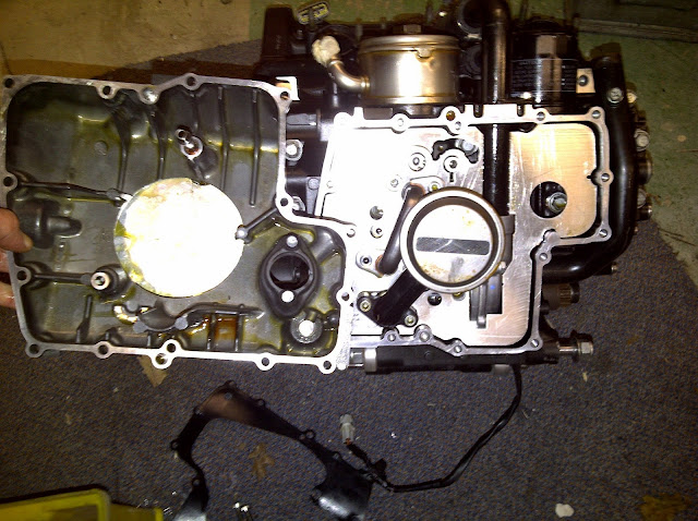

r1 baffle plate - too restrictive
Got a 5vy R1 and baffle plate supplied by Malc, i just have a concern the plate looks a little too restrictive, what do you think?-

| posted on 31/1/11 at 02:51 PM |
No I wouldn't have thought so, it's designed to keep the oil pump pick up point submerged all of the time by stopping any oil slopping
around under cornering etc

| posted on 31/1/11 at 02:59 PM |
Maybe some watch-pocket slots to allow faster drain-down?

PAUL FISHER
| posted on 31/1/11 at 03:48 PM |
Looks fine to me, hot engine oil will find its way through that no problem.
Davey D
| posted on 31/1/11 at 04:45 PM |
On mine ( 5vy with baffle plate) if i travel at a sustained 8k RPM for a few minutes on a motorway then my oil light comes on.
I think it is because it is either too restrictive at higher oil flow with higher revs, or that a lot of oil is flowing back down around the oil level
light pushing the float back down again. once i drop my revs back down to 7krpm, then after about a minute the oil light goes back out again.
One of my jobs to do before the car goes back on the road in spring is to modify the baffle to remove the butterflies in the drain holes.
Major Stare
| posted on 31/1/11 at 09:49 PM |
I have a very similar plate in my 5PW R1.
Most the oil is kept below the plate, so no worries. If it was a problem, it would be designed with more openings!

| posted on 31/1/11 at 10:03 PM |
I removed the "butterflys" from mine as I had the same problem as Davie D. Still got it but after 10000 miles and some very long runs with
the level light on it's suffered no ill effects.

MK9R
| posted on 14/2/11 at 11:24 AM |
I was so worried i ordered a new one of AB Performance, when it turned up and i compared them the one i had is exactly the same, apart from the
butterflys were no in it!! I've realised the photo flash makes some of the holes disappear!! Anyway at least i'm now confident it works,
and will have one for sale now!!

nitram38
| posted on 14/2/11 at 12:04 PM |
Guys I supply them to malc and some to AB so that is one of mine!
Butterflies removed not because of oil flow but because they eventually break off and end up in your sump.
I've sold these to racing teams in USA, Norway and Finland and they keep ordering more for projects.
Nothing is going to completely save your engine if you are an out and out racer like an accusump or drysump system, but these are a damn good cheap
alternative for road cars.

MK9R
| posted on 14/2/11 at 12:05 PM |
quote: Originally posted by nitram38
Guys I supply them to malc so that is one of mine!
so why didn't you post a few days ago and save me a load of dosh

nitram38
| posted on 14/2/11 at 12:09 PM |
You should have done a search or asked on here first?
