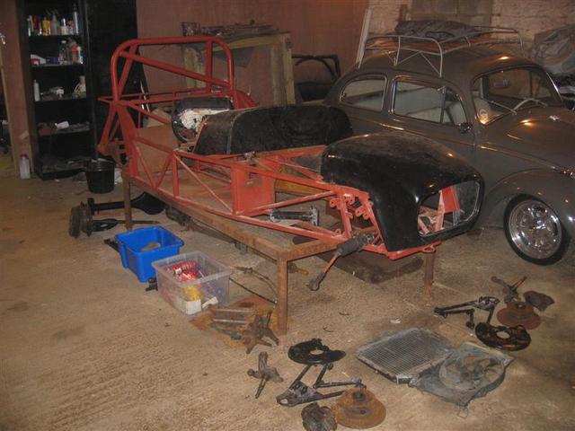

Nosecone ID?
I've got a nosecone that came with my chassis and a load of bits. Offering it up it doesn't seem to fit, would you agree as I haven't
been able to comapre to another car.
  What nosecone? resized
Any idea what the nosecone would be from?

Ben_Copeland
| posted on 21/2/11 at 08:25 PM |
Looks similar to a caterham copy. Little bit difficult to tell from that pix

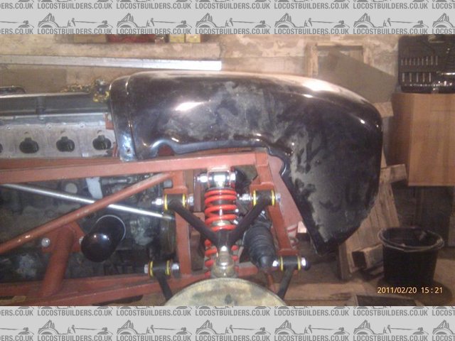

g60_edge
| posted on 21/2/11 at 08:34 PM |
cheers for the response
Do these photos help?

mangogrooveworkshop
| posted on 21/2/11 at 08:50 PM |
Its a caterham copy.... the cone you want is the mk cone it will fit..
| posted on 21/2/11 at 08:53 PM |
I cut a Caterham nose and grafted 4" in to make it fit my chassis.

paulf
| posted on 21/2/11 at 09:13 PM |
Its a caterham copy, I bought one for my car and at first thought that it would not fit but did eventually make it fit neatly.The side panels need to
be extended to fill the gap between the nose cone and front of the chassis, they are quite low from top of the chassis to the bonnet line but if your
engine will fit below the bonnet then it looks nicer than a tall nose cone .

g60_edge
| posted on 21/2/11 at 09:29 PM |
The bonnet line from the scuttle to the nosecone looks like the problem to me. I've got a bit of RHS showing this on the photos, you can see
it's not tangential. So the nosecone would need to be angled forward. This then leaves and gap between the top chassis rail and the nosecone,
which is curved. I can't see this ever looking good by filling with side panel.
Are the proper ones that much taller? I was looking to get an Allied Motorsport one advertised on here.
paulf
| posted on 21/2/11 at 09:41 PM |
Yes that was the concern I had with mine I was going to take it back but there were not many choices available when I built my car. I moved it
forwards a small amount and added a piece of metal to the front of the top chassis rail and radiused it to fit in the corner and then raised the rear
edge slightly to allow the headlamp mounting bar to fit through the larger cut out at the rear.It did leave a small gap above the chassis due to the
curve on the underside of the nose cone and I did consider filling it in but never have got around to it and it does not really show.
