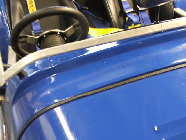

I have been looking at fitting the windscreen I have had for a while and at first I thought it may be wrong shape for scuttle but not sure now. It is
flat for a fair length along the bottom then curves down about 25 to 30mm.
Has anyone got a picture of their screen before fitting and after if possible,

Here is what I have .........
With screen sat on top
  Gap if sat on top
Or sat at bottom
  Gap if sat on bottom
Full width
  sat on top of curved scuttle
Do you think it would look OK with an infill piece of rubber trim ? There is a groove under the bottom rail of the frame to take a "T" or
"P" shaped lip
RD

it looks a little like an MK scuttle, but from the picture of the car it would appear that your scuttle is not deep enough for an MK. An MK locost
prehaps?
sorry not to have been much help.
Ditch
PS i have an mk and my screen has a rubber P seal about 50mm long that masks the car to screen join and i think it would work well on your car

Quite a few pics in my archive under windscreen & bodywork - your screen is flatter than mine on the bottom, though. I got my screen from Kit
Spares direct ( GBS ) aka robin hood - they will be able to supply you with the 'T' section rubber you need, but you might need to ring
them.
Link.
Then theres always places like woolies...woolies trim

Send me the profile of the scuttle and I will be able to make you the exact profile
