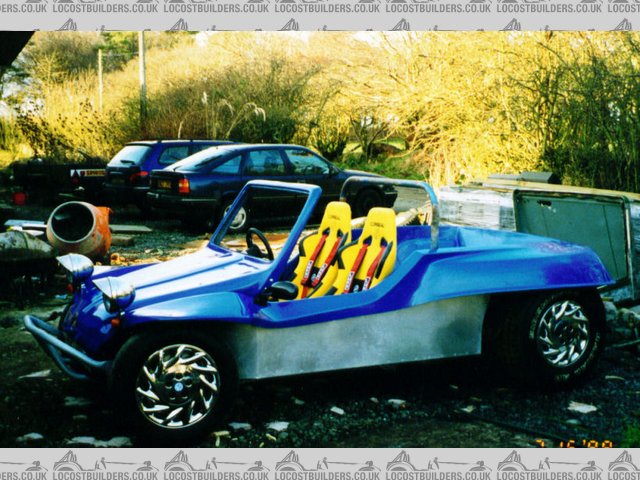

a good rub with t-cut should get through it onto the nice clean gelcoat. My beach buggy shell had been sitting in a barn since the early 70's so you can guess how wonderfull it looked...the orginal bug chassis had all but turned to dust too. A fair bit of elbowgrease got the shine right back like new and all I had at hand was a large bottle of t-cut
infact I forgot I had a picture of it after I'd worn out my arm matt blue to shiny
[Edited on 13/4/11 by Mr Whippy]
