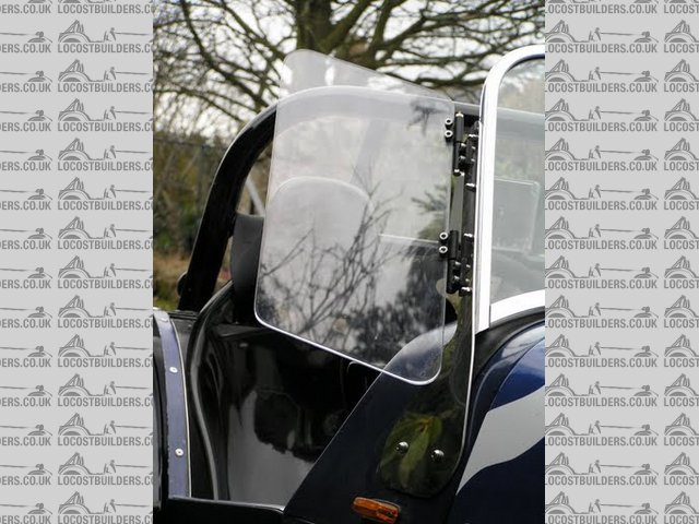

Once again I'm thinking of adding a pair of these to my windscreen:
  Wind deflector
(Apologies to whoever took this photo - I can't remember who you are!)
I do prefer having a full windscreen instead of fly-screens, and most of the time it offers all the protection I need. However, I do get buffeted when
going at 70-ish. I don't want doors, so maybe this is the only option remaining.
So, the first question is - do screens like this help to reduce the buffeting?
And the second question is - where would I get the hinges from?
I presume that I should use a tough plastic like Lexan for the clear bit.
All help appreciated!

They certainly do help buffeting. I used Caterham hinges on the basis that they're cheap from Caterham (or relatively) and they fit the Caterham
side supports. I used some polycarbonate that some kindly left outside my garage to make them.
the main problem with the ones I've got is that they have a tendency to ride up off the hinges due to the airflow at speed and the rake of the
windscreen. Ended up tieing them down with string
BenB
| posted on 16/6/11 at 02:22 PM |
Aha- I see the person in the photo has replaced the top hinge with a bolt- cunning thinking. Would stop them lifting off at speed nicely.
Ben - I thought my picture was of your car! (but I wasn't sure...)

Mine are made from 1mm Lexan bolted directly to the screen support with no hinges just button headed screws . Made a cardboard template, cut the Lexan
to size,clamped it in a sheet metal bender and used a hot air gun to warm it whilst applying light pressure on the bender. Been on around 3 years now
and only just starting to crack and whiten

I have had Lexan wind deflectors two ways:
1. bolted to the screen support and bent as above
2. fixed with side screen hinges - the issue there is that they obviously don't stay in position, so I made a bend at the bottom and put some U
trim on the bit which touched the side of the car.
I would prefer to be able to bend them in and out but I haven't seen those Cobra hinges except on Cobra deflectors which are somewhat pricy. The
deflectors bolted direct and bent to shape works better overall and is cleaner looking, somehow.

| posted on 27/6/11 at 12:27 PM |
Well - here's the final result.
  Wind deflector
In the end I decided to do without hinges - I used strips of 3mm stainless steel, bent to 45 degrees, to support the 3mm Lexan polycarbonate. These
straps can be bent/remade to different angles if I feel the need. I think it looks tidy with the reasonably well-polished steel.
I was shocked at how easy it is to scratch polycarbonate, so when these have got too marked then I'll probably try another material.
They do seem to reduce the buffeting though, which was the main objective after all!
