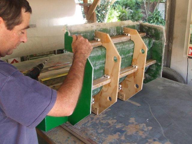

Fred W B
| posted on 18/10/11 at 05:32 PM |
Example of wood bracing on a mould
Fred W B
You can do it quickly. You can do it cheap. You can do it right. – Pick any two.
