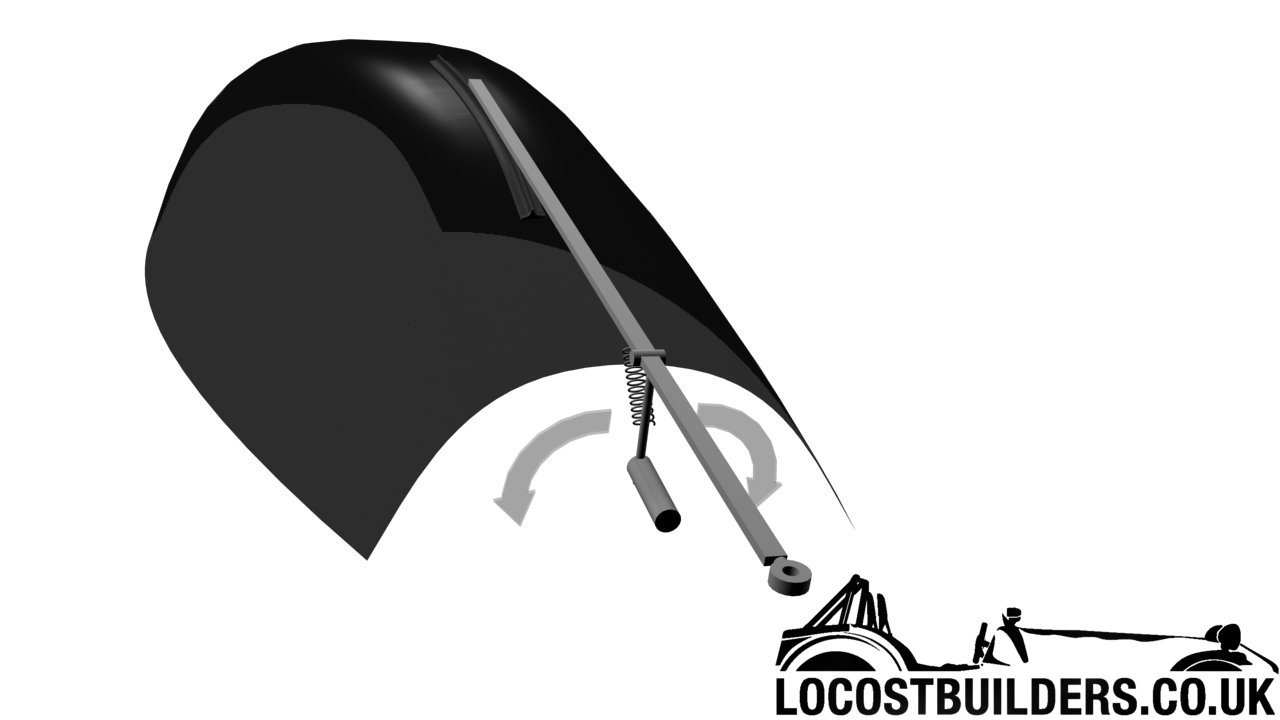

posted on 8/11/11 at 03:24 PM Reply With Quote
I think I have the mechanical solution - just requires a mount oscillated by a normal windscreen motor, and a high angle rose joint at the fixed end... Should countour around the screen and keep the blade angle against the screen constant....
Too barmy?
[Edited on 8/11/11 by cloudy]
www.warnercars.com
jossey
posted on 8/11/11 at 03:45 PM Reply With Quote
thats like what i was thinking just your cad work was better than my paint work :O)
David Johnson
cloudy
posted on 8/11/11 at 03:51 PM Reply With Quote
It's OK I saw where you were coming from! - by adding the fixed pivot to that it also parks more in line with the body down the side
www.warnercars.com

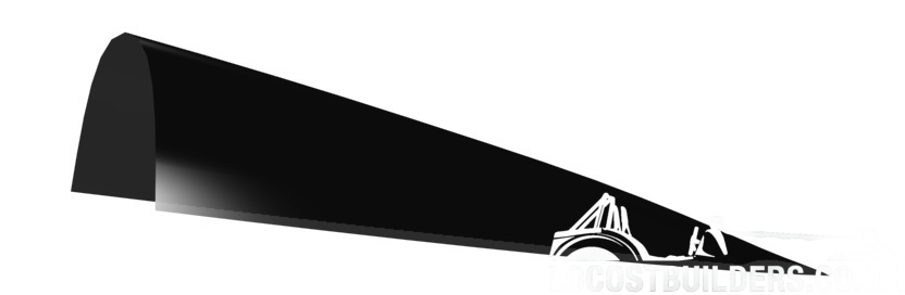

Tiger Super Six
posted on 9/11/11 at 03:48 PM Reply With Quote
Look at a lotus elise, pretty much the same shape windscreen you have drawn.
Mark
Tiger Avon
cloudy
posted on 9/11/11 at 03:59 PM Reply With Quote
The windscreen is nothing alike! though the drawing doesn't show it too well - think glider cockpit...
James
www.warnercars.com
