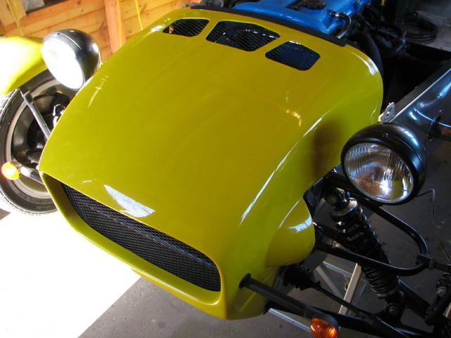

Smoking Frog
| posted on 1/2/14 at 11:14 AM |
Cold air feed.
  Cold air intake
Nose cone vent.
  Nose vent
Bonnet vent.
  Bonnet vent
Can't say how effective they are as not on the road yet. Those bonnet louvres look good.

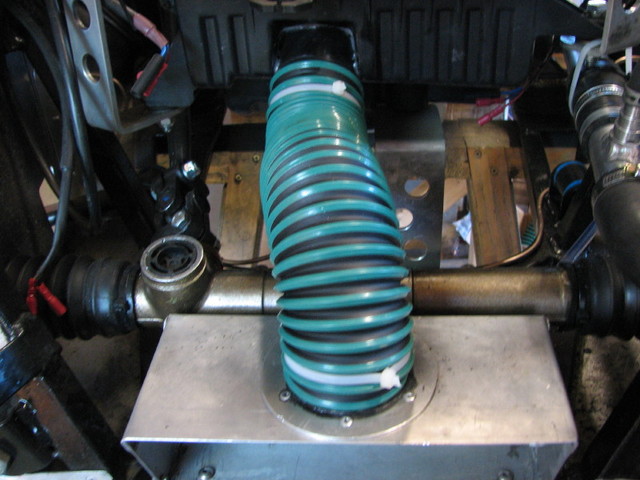

| posted on 24/2/14 at 09:34 PM |
The rain just trickles out of the bottom of the rad ducting.
  rad duct 02
ATB Dan.

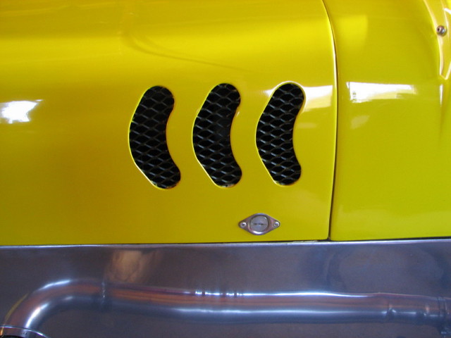

SausageArm
| posted on 13/3/14 at 12:20 PM |
Scutter - that ducting looks great!
I've not done anything with regards to ducting the air in (yet) but vented my bonnet like this
Xgas
| posted on 13/3/14 at 05:50 PM |
Blime.... That looks fab.
But how do you stop the engine getting drenched when parked in a rain storm?
SausageArm
| posted on 13/3/14 at 11:51 PM |
Thanks.
In that example it would just get wet, but I've never had an engine issue with it being parked or driven in the rain.
