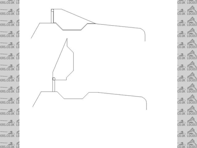

Crazy Jay
| posted on 5/12/04 at 06:58 PM |
If i was ever building doors/roof on my indy, i would make a roof, kinda like a Hardtop u'd get on an s2000 mx5 etc. One piece. Put a hinge on
the rollbar and to get in lift the whole roof up using "bonnet lifters"(technical term offcourse)
Here's a quik pic (made in paint, so shit)
[Edited on 5/12/04 by Crazy Jay]

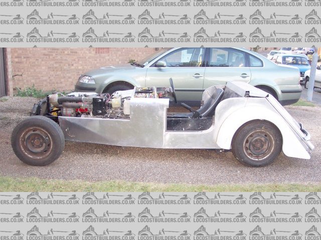

stephen_gusterson
| posted on 19/1/05 at 04:45 PM |
this is a pic of my chassis - im not a structural engineer, so proceeded the way i saw best. Its not folded in half standing on its wheels the last 2
years anyway!
Basically, I dropped the sides from (12 ins?) to I think 8.5 ins.
The whole section under the doors is doubled up inch section, to form an oblong box, with a 1.6mm steel plate welded on the inside. There is a lot of
extra bracing into the rear bulkhead, and inch section X braces forward of the doors instead of the simple single round tube on a locost.
The door frame is then 'shaped' with 25mm strip just like the radius at the drivers shoulder is done on a std car.
The 'lip' at the extreme back of the base of the car has been chopped off.... i had ideas of mounting sierra suspsension from there but it
didnt work.
an addition, not on the photo, is extra bracing at the front of the door. I have welded 3mm truncated triangles in the areas shown in red. There has
also been an upstand tube added above that area to allow for a top hinge mount.
atb
steve
stephen_gusterson
| posted on 19/1/05 at 04:50 PM |
with alu sides added.
i havnt taken a pic since the doors were put on.
if I was doing it again, id make the doors longer in the forward direction. Note its not really a locost, rather a morgan adaptation of
one.....
