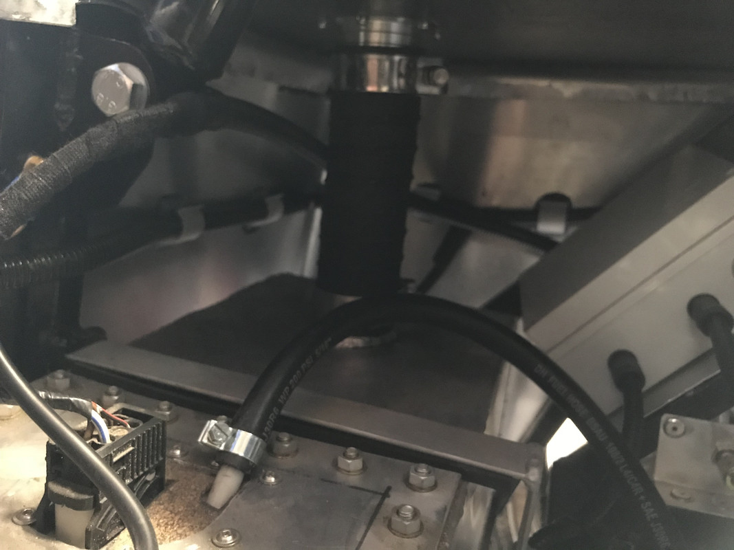

thanks for your help, here is the end result with it fitted to rear tub cover and hooked up to fuel tank.
The filler cap is IVA ok with key not removable and fuel hose is certified for petrol use with certificate.
