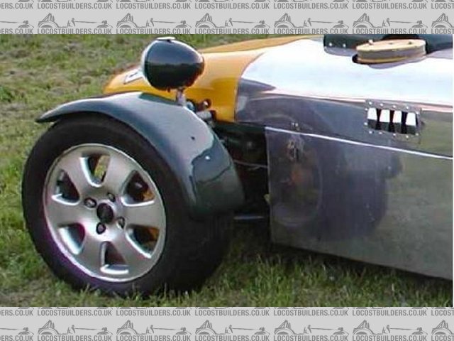

I did this to mine and it has reduced the under bonnet heat by a considerable amount and it also lets air out of the engine bay once it has gone through the radiator.
Other option is to go with the westi£ nose arrangement and have the air pass in the nose, through the rad and up out the top of the nose thus not letting as much air into the engine compartment.
Mine were pretty simple to make though and cost nowt but a bit of time.
vent
vent
and a closer one
vent2
vent2
