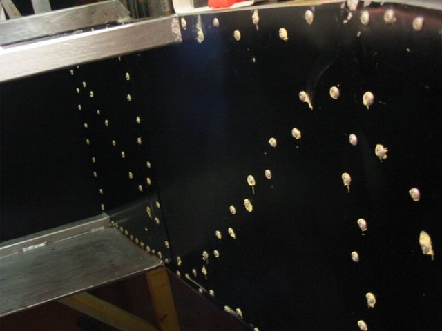

There was some talk a while back about someone bonding the floor panels in place.
BTW this is a piccy of the rivets i have been using, sorry it's a bit out of focus.
the yellow stuff in the second piccy is the jointing compound before I cleaned off the excess.....
rivetc closeup
rivetc closeup
rivets
rivets
Dave
