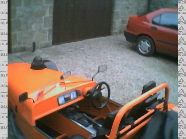

Used one from an escort(No angled ends.)Cut and filed the stem.Taped M6 and fitted bar.Bolt welded on bar.Sorted. Rescued attachment Sreen1001.jpg
