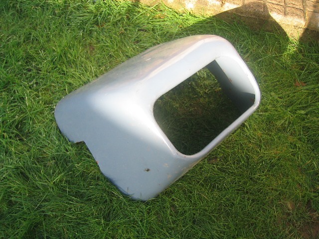

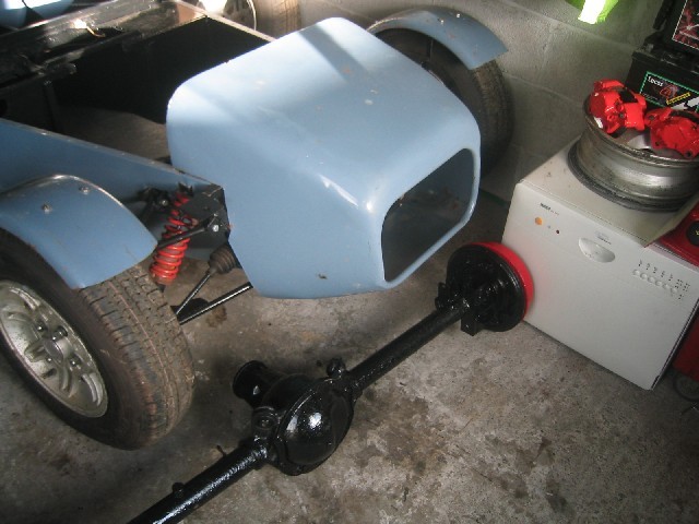

Ben Graber
| posted on 29/11/05 at 01:31 PM |
Should i go for 1mm or 1.5mm then? I'll let you know when i'm ready for some paint Mark, i fancy purple velvet i think. Here are some pics,
proper steel!!
Ben Graber
| posted on 29/11/05 at 01:32 PM |
And another ...

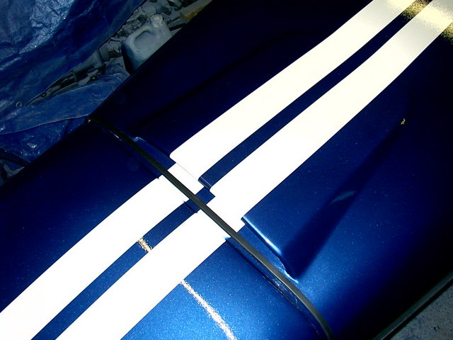

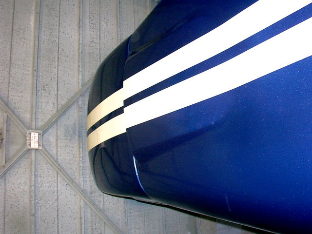

PaulBuz
| posted on 30/11/05 at 08:59 PM |
I used 1.6 mm half hard.
Formed ,made bonnet bulge,etch primed & painted a lovely java pearlescent blue!
Paul
PaulBuz
| posted on 30/11/05 at 09:01 PM |
bonnet
