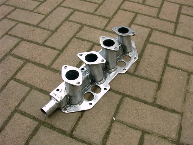

| posted on 11/1/06 at 06:23 PM |
inlet manifold
