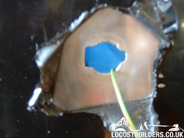

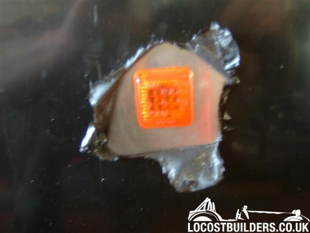

Johnmor
| posted on 4/4/06 at 05:11 PM |
Repeaters
I have just fitted mine this afternoon.
The main hole is 21mm but you have to file an area either side to allow the unit to push, turn and lock.
The is a rubber seal and a wire sleeve.
.JPG)
stevec
| posted on 4/4/06 at 05:22 PM |
Thats the critter.
Thanks.
