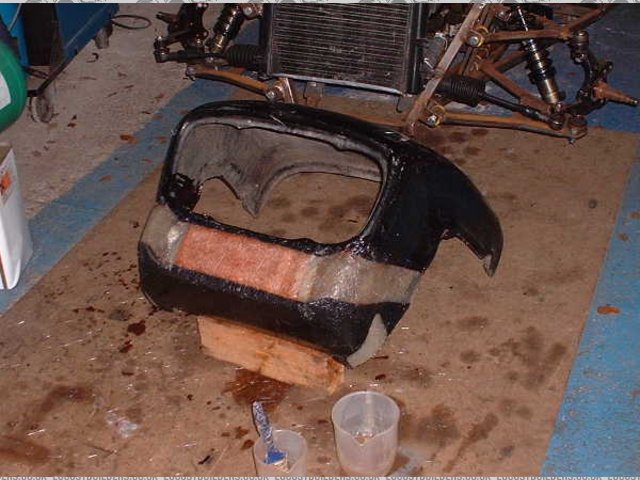

| posted on 24/4/06 at 04:35 PM |
I am currently trying to make a nosecone I bought from Jambojeef fit my 442. I've cut it to make it higher to suit the 442 chassis and am trying
to make a flared arch to cover the wishbone mounts. It might look a right pig by the time I'm finished (it's called research and
developement)  . I'll post some photo's later if I can face the cold garage (blowing a gale here).
| posted on 24/4/06 at 04:53 PM |
Mine's only higher.
I've been doing the same today with a nosecone I bought to hack up. I've found that fibreglass has a mind of it's own till the resin
starts to go off and also cling film is good for holding it in place till it does so. A layer of cling film then gaffer tape on the front and glass it
from the back, peel it off when it sets and leave it till it's ready for bodyfiller. I'm going to try the plasticine bulge to glass over
for the wishbone top brackets.
| posted on 24/4/06 at 05:38 PM |
The story so far.
Next step is to raise the top then put the bumps on the side to cover the ears and top wishbone brackets
