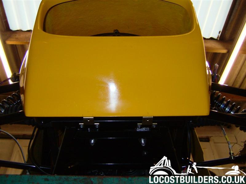

Over Centre Bonnet Catches
Nose cone is hinged on bottom rail and using 2 bolts into riv nuts on the top rail
See Pic
