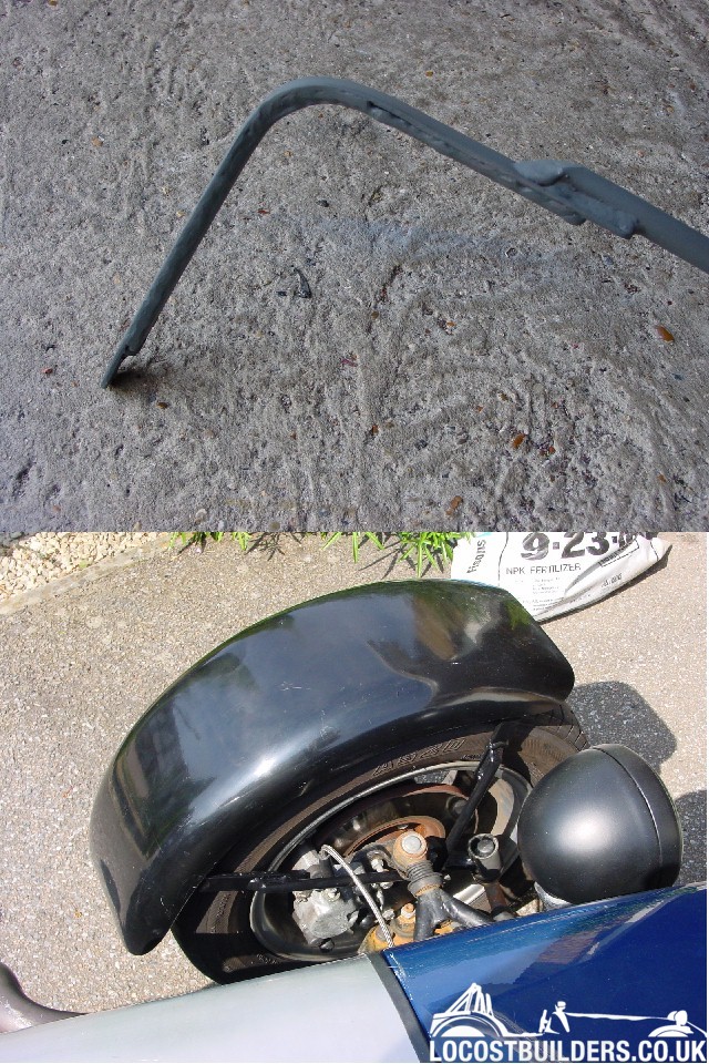

posted on 30/7/06 at 07:42 PM Reply With Quote
Mine were 4mm and having had to repair them 3 times in 2,000 miles I'm going to make new ones from heavier gauge steel. Do a search and see for yourself how often they break . Best of luck

Humbug
posted on 5/8/06 at 10:06 AM Reply With Quote
I too had a problem with the Stuart Taylor (similar to Lolocost) bracket breaking after about 1300 miles. The original flat strip was only 3mm thick. I had it rewelded together, then all the arms strengthened by welding a 4mm strip of steel on the inside of the original flat bar, so it's now a total of about 7mm thick. I think if you use 6mm thick flat steel you should be a lot better off than 4mm.
