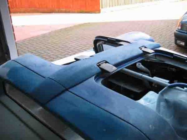

I am making a decor panel to disguise some rather industrial looking hinges on my gull wing windows and ended up with this ....
It is worth mentioning that everything will be painted body colour when done.

| posted on 25/8/06 at 06:41 PM |
I am thinking of putting some mesh in the front, making it look like a small roof vent - I could even make it funcional at a later date.

| posted on 25/8/06 at 06:42 PM |
So what do you think guys? I know you will be honest with me so say what you feel!

nib1980
| posted on 25/8/06 at 06:46 PM |
looks good. would look bettwer with a shark fin ariel on the back to follow the sweeping lines?
just a thought
EDIT: my spelling is aweful
[Edited on 25/8/06 by nib1980]

scotty g
| posted on 25/8/06 at 06:54 PM |
Looking good, i might of tried to fit some sort of air intake at the front maybe?
RazMan
| posted on 25/8/06 at 08:29 PM |
That what I intend to do - the curved front face will be replaced with mesh. An oId college teacher of mine once said that if you can make something
have more than one function it is easier to justify its presence. In this case the vent will be cosmetic but I just wanted to run it past you guys
before I started to pretty it up a bit.

Hammerhead
| posted on 26/8/06 at 09:18 AM |
I'd blend it in more. so its more organic etc. Just my 2p.
RazMan
| posted on 26/8/06 at 09:56 AM |
Point taken - I am going to blend the whole lot in to take away the sharp join lines.
Raz
andyps
| posted on 26/8/06 at 10:32 AM |
Is it possible to widen it to hide more of the hinge, and include a cutaway for the parts that are currently siting on the body? Might look even more
integrated that way, but looks good anyway. Mesh to disguise a scoop would probably improve it but difficult to tell until it is all one colour.
RazMan
| posted on 26/8/06 at 12:30 PM |
Originally I started out with a wider version but decided it looked too clumsy and trimmed it back.
I know what you mean though - the hinges might look better when the edges are chamfered down a little and painted the same colour.
Raz

02GF74
| posted on 30/8/06 at 09:48 PM |
tht version is better; but being picky - can you extend it to cover some of the hinge or will that interfere with the door opening?
RazMan
| posted on 30/8/06 at 09:57 PM |
I could probably extend the hinge cover area another 10mm or so to cover more of the pivot pin - any more than that and it will risk getting hit when
the door is opened.
Raz
leto
| posted on 31/8/06 at 06:44 AM |
When you said “chamfering down the edges” I thought you meant the hinges. I think they are a little too square to fit in. Is it possible to chamfer
or round the upper edge slightly? (only did one hinge in the pic.)
Maybe a small radius in the corners of the hinge slots.

stulad
| posted on 31/8/06 at 06:55 PM |
Cool That looks miles better well done nice job , looks more like its there for a purpose now
how did you build it up ?
is it just fiberglass filler and normal filler?
RazMan
| posted on 31/8/06 at 08:04 PM |
That's pretty much it really - I made a matt & resin baseplate and bonded the previous version to it with bonding paste, then filled in the
rest with fibre filler and topped it off with normal filler and shaped it all with production paper.
The vent is cosmetic at the moment although I might be doing something about that later.
I thought about your idea of applying filler to the hinges to make everything flush but the their shape didn't make it easy so I had to
compromise. I have since covered the hinge pivots a little more which makes everything a little smoother visually and I have now got to blend the
whole thing together - but thats another day
Raz
