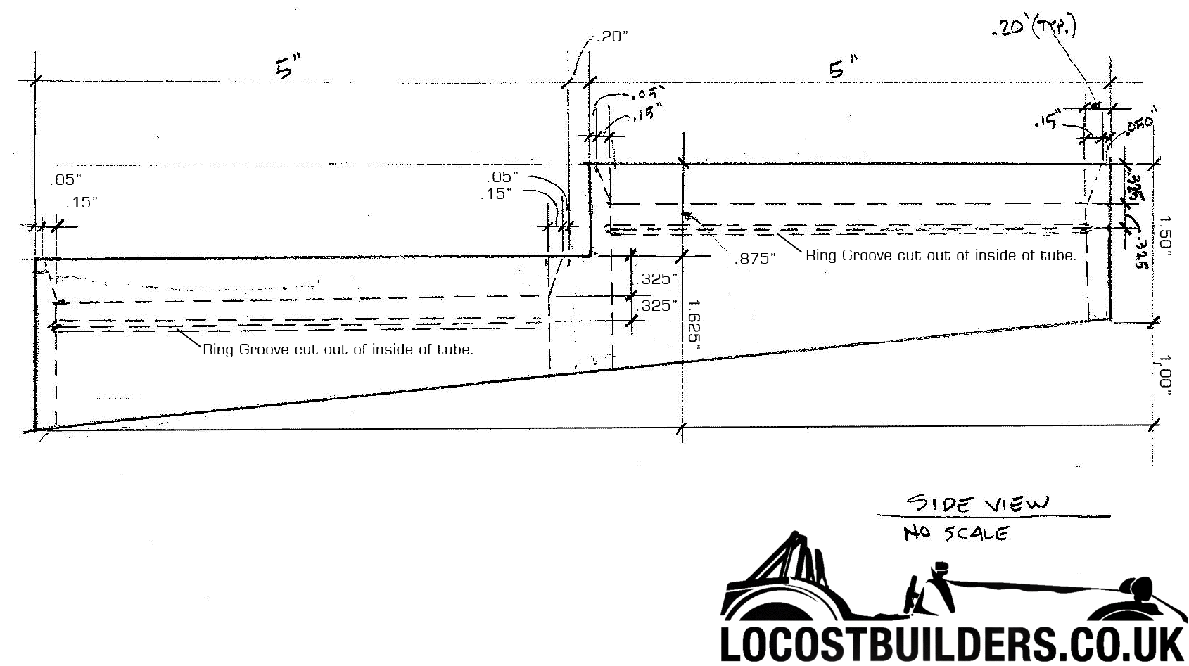

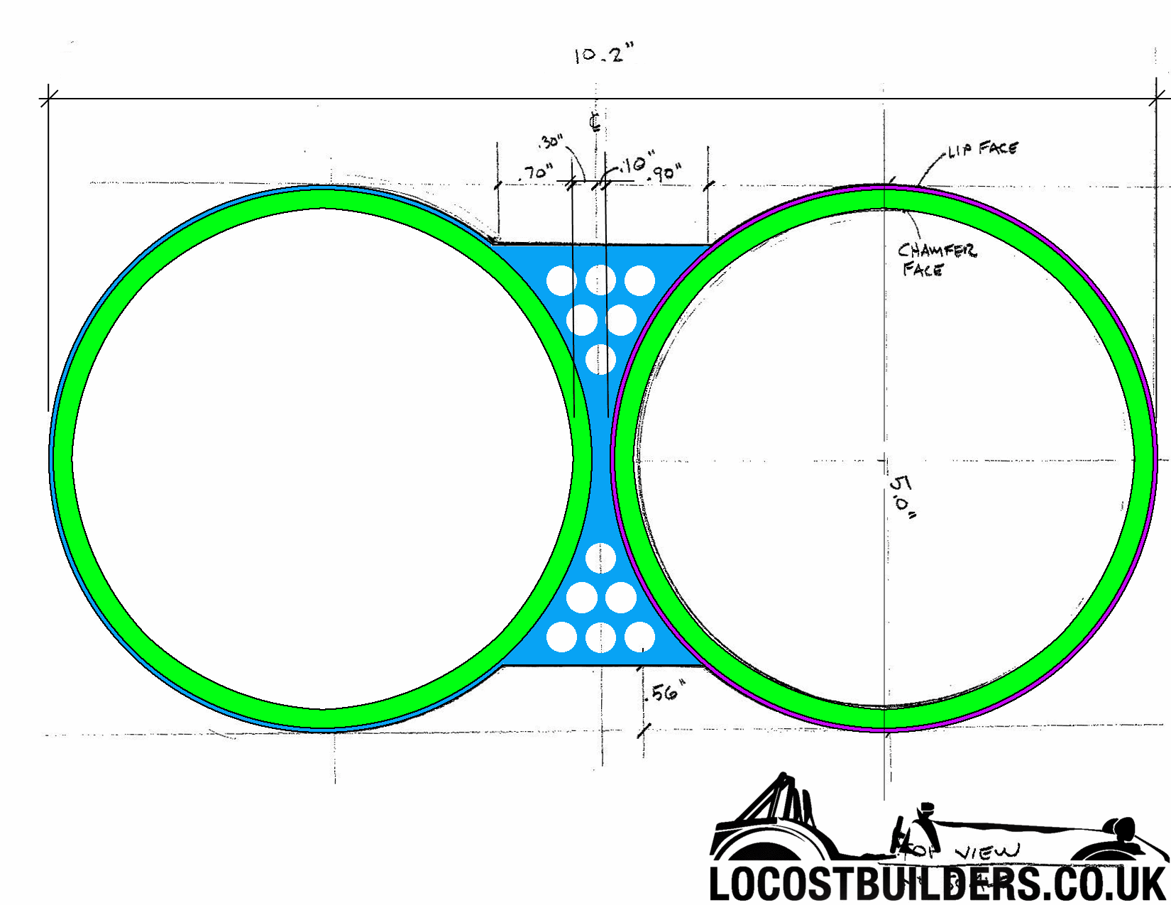

Anyone care to take a stab at Solidworks for me?
I am good at 3DS but just a dabbler in Solidworks. I need to create something as a SW file that is out of my current capability. Is there anyone here
that would be willing to help me by taking my sketches and making a solidworks file out of it for me? (Am I being a cheeky b@st@rd for asking this?)
(I have version 2006 of SW -de-reg'd- for the person willing to help. PM's only regarding this pls.)
Here are links to my sketches (and I think the main dimensions are there. I can explain in further detail if required.)
Click to view Front Sketch
Click to view Side Sketch

| posted on 22/9/06 at 05:16 PM |
Job done
One thing that isn't on the drawing is the dimensions of the groove that is cut into each bore.
Also the material/finish etc, whether you need any draft angles or fillets (radii) putting on the sharp edges etc...

sgraber
| posted on 22/9/06 at 05:29 PM |
HOLY SHIT ANDY!
I haven't even had time to check my u2u's yet and you've finished the part! (BTW I just read the U2U's and thanks so much
guys, but it looks like Andy has done the deed.)
It's very, very close to what I need.
The material is aluminum (Don't know the proper type though), The groove is 1/16" deep.
The turn signal holes need more defining and as well there will be two tapped holes on the back side to attach to the bodywork.
Let me get back to you with U2U and we'll talk about all kinds of stuff.... LOL
