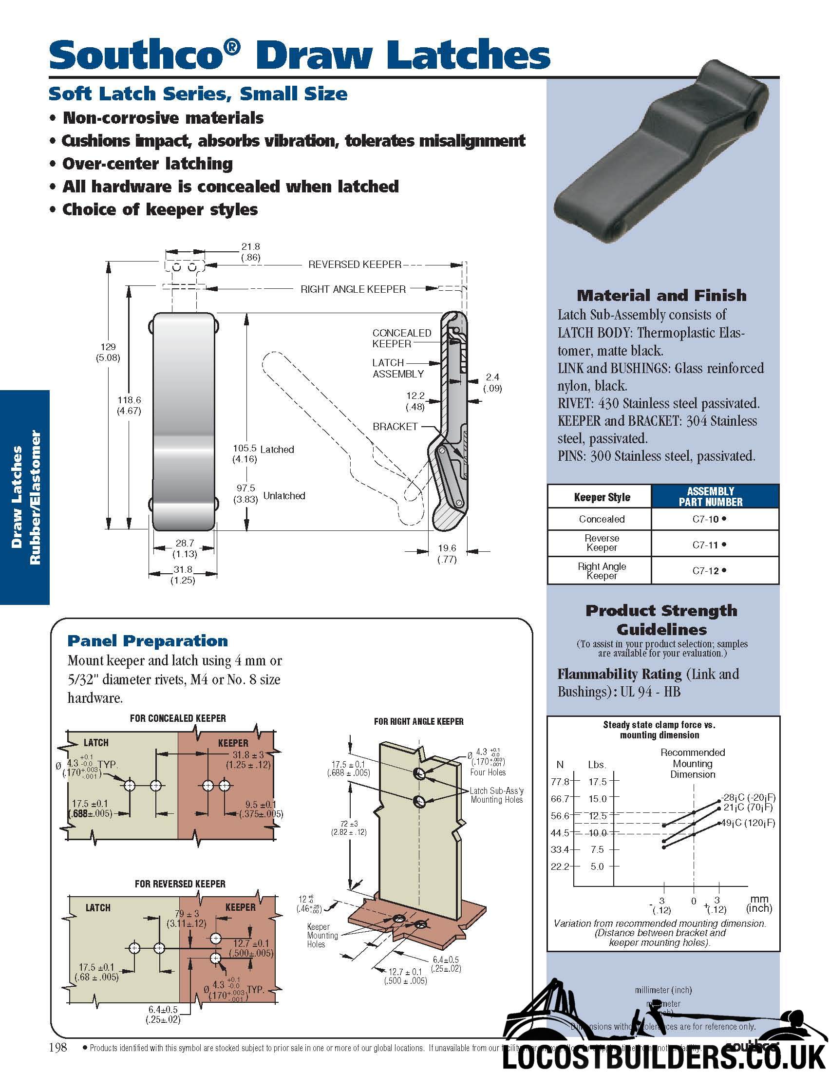

Does anyone have a mounting template for the SVA friendly rubber bonnet catches?
I want to make sure my bonnet doesn't fly away!

You normally get template with catches mate, will take pic and post it
Humbug
posted on 13/11/06 at 03:50 PM Reply With Quote
Is it this type:
http://www.locostbuilders.co.uk/upload/5-3-1-1[1].jpg

well done that man same image i had

If you cant get sorted... one on our website.
