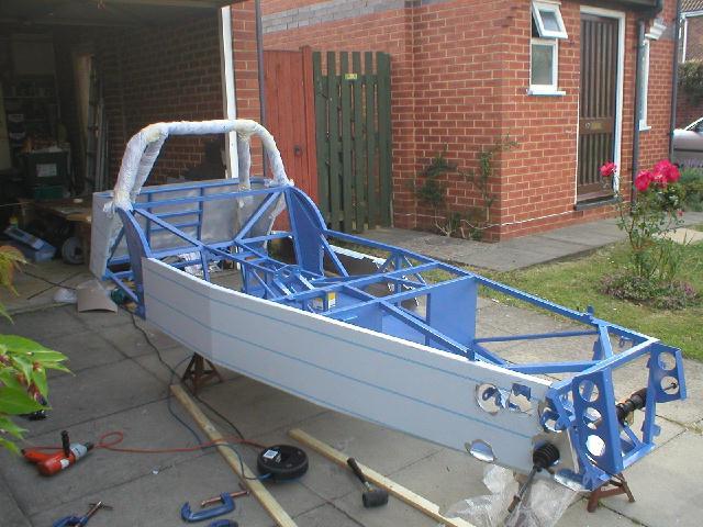

Anyone got any tips for the top and bottom folds when doing an ali rear panel.
Got one half made, but I think I could get it a lot better and neater with a bit of guidance.

Don't knock over the straight bits and leave the curved bits until last, you'll end up with too much metal at the curve.
Move around the whole panel gradually knocking it over a bit at a time along its whole length. When it is completely over the curved parts will be a
bit rough, but you can sort it out by filing any excess and hitting it hard with a hammer. When finished emery and polish.
I found it helped to wedge some bits of wood between the upper and lower rails to give some support, and also clamped some boards over the three faces
to prevent them bowing.

I made a cardboard template for the back panel allowing the same amount of of extra all around. I cut the ali to this and fitted it to the frame,
turning the vertical edges over at the back of the wheels before doing the top and bottom. At the bottom I had square tube so I folded a 25mm flange
on the straight bits, which was pop rivetted underneath, and left a 10mm flange unfolded on the curved bits. This 10mm flange was tapped over after
everything else was finished.
Photos of back panel template and in ali before beating the life out of it.
Oh and thanks for the kind comments by the way. Of course since it's been on the road it's picked up all manner of dings and dents.
