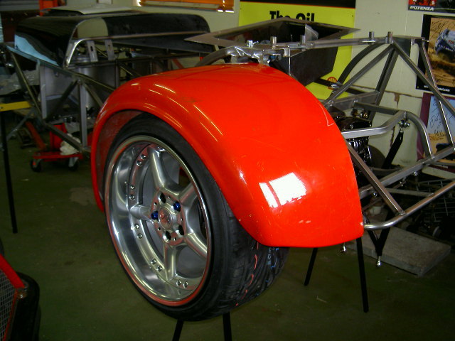

Do the rears fit an mk indy, Has anyone tried?
Hellfire
| posted on 1/1/07 at 06:28 PM |
Somebody is currently trying - Picture courtesy of Svenkev. I think the Dax front and rear arches would look great on an Indy.

Liam
| posted on 2/1/07 at 06:29 PM |
A dax chassis tapers inwards (i.e. gets narrower) from the front of the rear arches to the back of a car, doesn't it? So if you stuck dax
arches on a parallel sided MK chassis wouldn't they look a bit wrong? I dunno - maybe it wouldn't really be noticable, or would look fine
even if you could notice?

Stu16v
| posted on 2/1/07 at 08:57 PM |
The Dax arches will not fit an MK or similar)without some fairly serious surgery. If you look closely, the Dax 'tapers' from the rear,
whereas most sevenesque clones taper form the rear of the scuttle - the rear section is parellel. This means the mounting flanges of the Dax arches
sadly are nowhere near.
It can be done though - my car has them. Ok, so not a MK, but you get the idea...

Mave
| posted on 3/1/07 at 05:50 PM |
I've fitted them to my Indy, but had to add a taper to get them straight:
/HPIM1430_medium.jpg)
