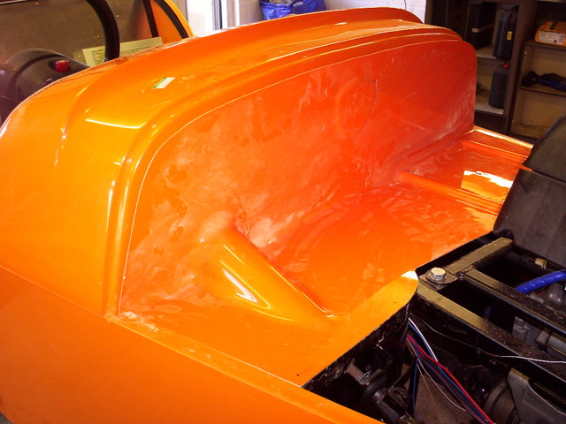

Kev99
| posted on 26/1/07 at 09:49 PM |
If u mean the battery tray area I used the GPR panel MK suppled
  Battery tray

darrenga
| posted on 27/1/07 at 07:24 PM |
did it fit properly kev or did you have to force it to fit,thats what i have been told dont know if its true
Kev99
| posted on 27/1/07 at 08:07 PM |
It fits fine after a bit of trimming up. The lip on the front edge overhangs by about an inch but I just removed it and trimmed it back to the
bulkhead. I also had to trim around one of the fireblade cradle mounts as well
  Battery tray 2
  Battery tray 3
