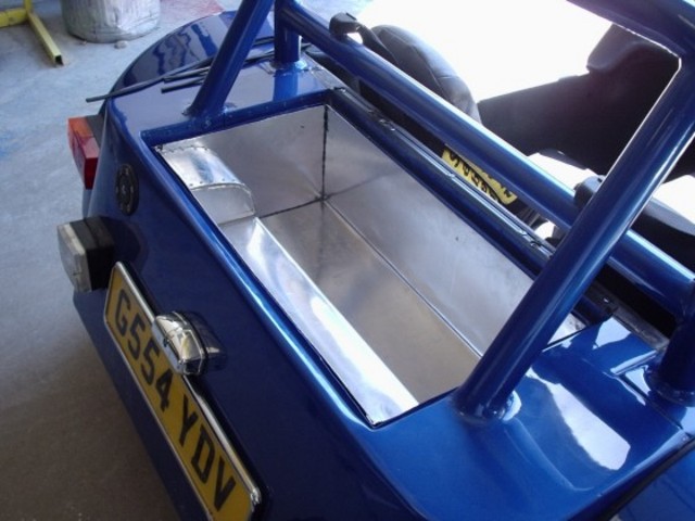

I made an insertable ally box, held in with self tappers
Mark Allanson
| posted on 24/2/07 at 09:03 PM |
..and with the lid on

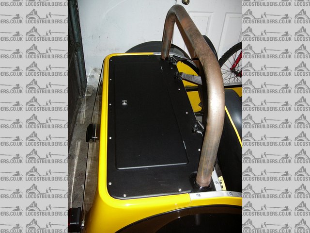

here's mine - 6mm ply, covered with 3mm foam, then black vinyl. Hinged section opens for access to fuel filler diff area etc (no boot box) and
has a panel lock although it's really only to keep the lid closed.
