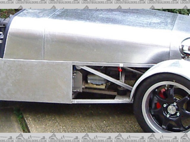

Hi All. May I pick your brains please?
What's the options for side bonnet catches? What have you used? (And where did you get them)
I would appreciate your ideas as the next job is the engine side panels, and I'd quite like to sort out the catches before I make them.
They would need to be SVAable.
Many thanks,
Paul G

| posted on 25/2/07 at 01:33 PM |
wow look at the panel gaps! incredible

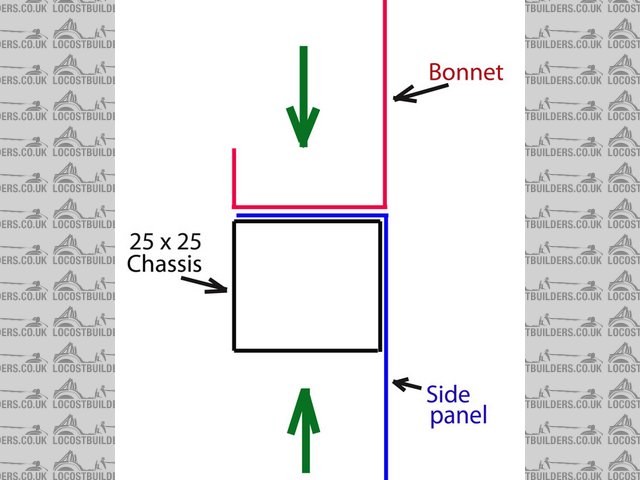

907
| posted on 25/2/07 at 05:45 PM |
A little more info
The bonnet has a double fold and this needs to be clamped to the chassis in the direction
of the green arrows, as my red G clamp does in my first post.
The scuttle & nose have a closed cell rubber strip that the bonnet needs to be pulled down onto.
Would the Aero or Dzus catches do this? (any pics?)

| posted on 25/2/07 at 05:48 PM |
The Dzuz catches won't pull the bonnet down to the chassis but the Aerocatches will . Also I think they are available in polished ally?

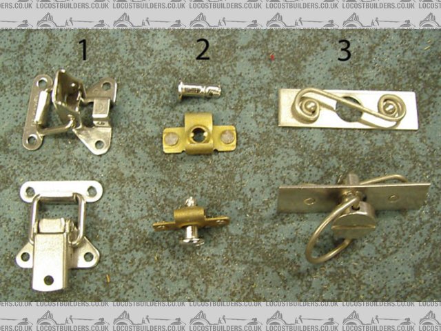

| posted on 25/2/07 at 05:54 PM |
I do have these but the Protex ones (No1) won't pass SVA, and 2 & 3 won't pull down.
I don't mind bits & bobs showing on the car because as it is it looks very plain.
A splash or two of colour (even black) takes the blandness away IMHO.
Paul G

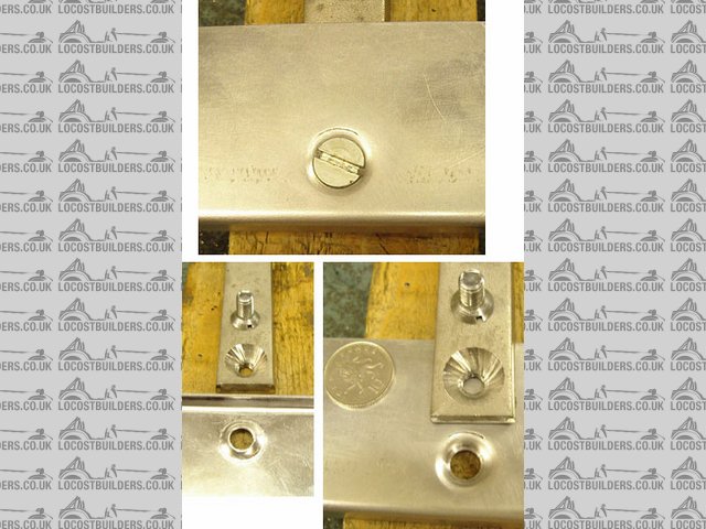

907
| posted on 27/2/07 at 10:06 PM |
Hi.
Been thinking. Oo er.
I'm trying to keep it simple (read cheap).
I had a play tonight with a c/s M8 screw.
If I make 4 lugs and weld them to the chassis, drill, tap M8, and countersink to 20mm dia,
then when the screws are tightened it pulls a c/s in the ally sheet.
This would act as a locating device when refitting the bonnet.
The screws can be done up with a 10p piece once the c/s is formed.
What do you think? It saves a shed load of beer tokens.
Paul G
Deckman001
| posted on 27/2/07 at 11:12 PM |
Nice and Locost, but could rattle loose me thinks ??
Jason
