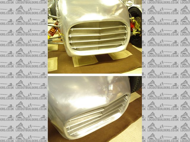

Opinions on my grill please
I've be playing again with my nose.
Before I make it permanent by drilling holes I'd value your opinions, good or bad.
My only worry is that it will restrict air flow, but I do have a whacking great rad in there. (RH Coolman)
Many thanks
Paul G
p.s. Please ignore cable ties.
[Edited on 15/3/07 by 907] Rescued attachment PhM-Grill-s.jpg

I don't think it should hinder the airflow too badly as long as the rad is tight up into the nose you should be fine.

That's one Seven that stands apart from the crowd. Very impressive, I love the new grille, thumbs up from me
BTW What colour are you painting it ?

Looks good, though the mesh is very tight??

I think it looks good.
I do think that the bottom vain needs a slight kink in it as well though.

I'd be worried about the airflow restriction - do a simple test, how easy is it compared to a lump of ply to push through the air?
so the restriction ......... fit it!

Looks great but I'd be worried about the airflow through the tight mesh

Wondered what you were up to sunday. Second the bottom vane though.Don't you just hate some people?

Hi paul, looking good but in my humble opinion I think you should set the mesh back towards the radiator to protect it, and 3 or 5 vertical bars to give the old style chip chop grill effect. If you are concerned on air flow put a more open mesh.
atb Trev

A wider mesh would look better and give less restriction.
Nice job

Kendo & Rusty, your right.
If I run a weld across the bottom vane while holding it under tension it would kink it a fraction.
They are folded from 1mm sheet to form a 30 x 10mm U section.
The fan is between the mesh and the rad and I was trying to hide it as much as possible.
You can still see the wires that run down from the top right to the fan.
Thanks again for the comments.
Paul G

Hi Paul,
It's looking good...moving on from the rolling chassis I first saw 3 and a bit years ago!
The grill looks good, but just thought it might look a bit more dynamic with 3 or 5 slats? It's a similar principle to car alloys, which usually have an odd number of spokes...like my favourite Compomotives!
If you put in 5, you might have to make the slats a bit more delecate, or it could look a little cluttered.
Just some thoughts, but it's looking good!

I would go with an odd number of horisontal bars, and odd vertical like Trev says. A different mesh might be an idea.
you must put a bend on the bottom slat, never put straight lines on a car. Sorry about the spelling, but if you think about it, Its your falt.

Gorgeous bit of work - though agree about the restrictive mesh and the bottom lat.
IMHO - that is the best nose I've seen on any se7en type car... you may be approached for it as a future pattern.

Def' wider/bigger mesh - but still AWESOME work.

mesh is too tight; makes no difference how big or efficient the radiator is if you cannot get sufficient air through it.
Paint fan etc: matt black if you are worried about it being seen through the grille.

Hi Paul, I've been away and have only just seen your new grille. It looks really nice. If you did decide on a more open mesh material it might well enhance the appearance as well as permitting a greater airflow. I'm looking forward to actually seeing your car hopefully this Summer.

But I would use a much less restrictice mesh myself... I've be worried about the air flow.
I think less restrictive would look nice too.

I agree with the comments above, odd number of bands and add a kink. I think three vertical bands might look good, slightly less prominent than the horizontals. Looking good though!

Absolutely stunning work (as usual!).
I would echo the concerns about the mesh though, Locosts aren't reknown for ultra efficient cooling inside their tiny engine bays at the best of times.

I can endorse the comments about the mesh - as previously discussed, the mesh I'd used was a lot more open than yours, but it still restricted the flow.
The woven stainless stuff I've got now seems to be helping quite a bit - it's mostly open space.
