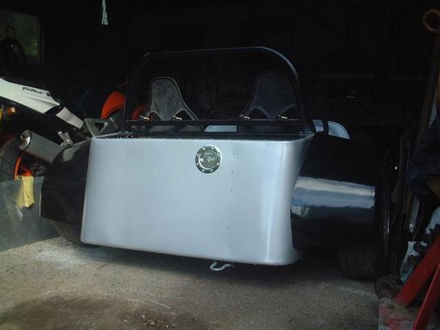

Mines on the back panel, but I chopped the rear part and put a 90 degree bend so it turns in immediately, this means that I can effectively fill vertically with no issues as the pump nozzle goes in at 60 degrees.
