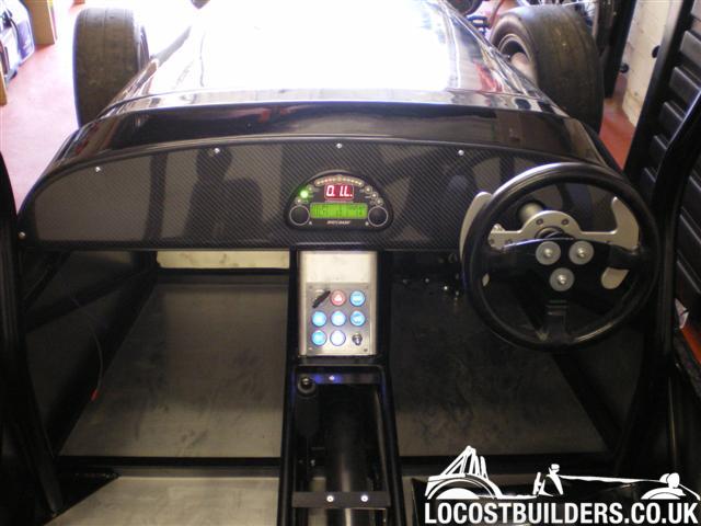

Avoneer
posted on 17/6/07 at 05:10 PM Reply With Quote
Finished result.
Pat...
