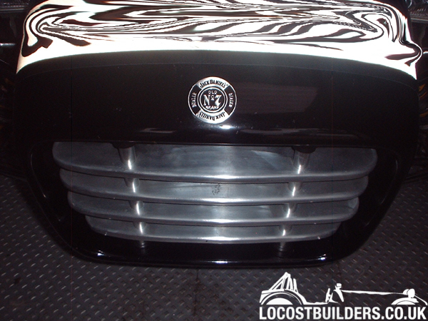

New Grill
[img]http://locostbuilders.co.uk/[/img]

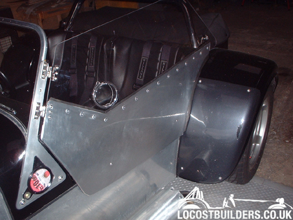

Drivers Door

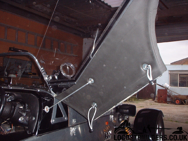

Door

they look heavy!

Even though I don't own a 7, that is some work!
I like the way your doors open

Love the grill the doors should be done suicide style to match

That looks really cool

They are lighter than the Dax supplied doors.The bottoms are made from 2mm ali sheet,I hammer formed over a ply template to roll the edges.

that grille looks wicked, how did you do it?
do you have any more photo's of it?

I love the grill.

top work i especially love the grill
if you decide you need to make another ill have one
