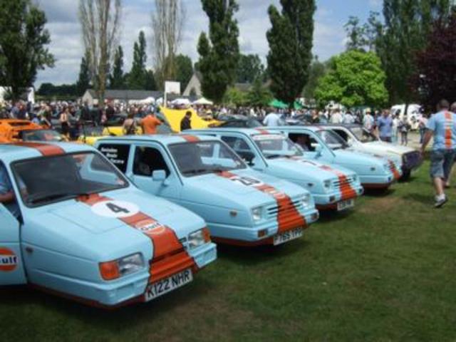

Strewth!!

that's great! thanks
like the rialtos!!!

Love the mini and the 7 in those colours. Not so sure about the plastic rockets though.
