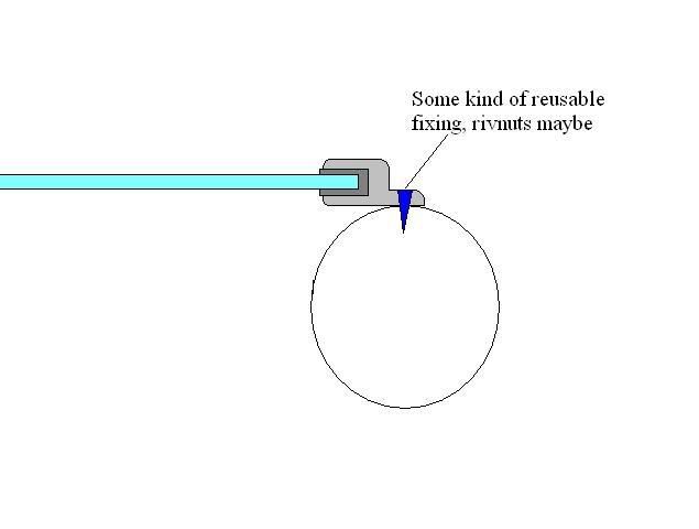

worX
posted on 3/8/08 at 05:13 AM Reply With Quote
If you fitted it from behind you could just weld a gusset round the bar that would sit on the front edge of the screen adn therefore was aesthetically pleasing and wind/rain proof and for the fittings in the back you could do a number of things, angled aluminium screwed into rivnuts would be my first suggestion.
smart51
posted on 3/8/08 at 08:04 AM Reply With Quote
weld a strip of 10mm x 2mm or similar round the inside of the whole surround. Fit glass to it using windscreen rubber. Weld the strip as far round to the front as you can and still get the rubber seal to fit over it. It might take some filing and filling to get a nice seam between the metal parts but it would look OK.
Mark Allanson
posted on 3/8/08 at 10:39 AM Reply With Quote
As above but put edging strip in the 10x2mm fillet and bond the glass to the fillet, neat and simple to fit

mr henderson
posted on 3/8/08 at 04:09 PM Reply With Quote
How about something like this, this is a cross section view with the screen to the front of the roll over hoop.
I should also have said that I would like the screen to be relatively easy to remove, should the user wish to do so
