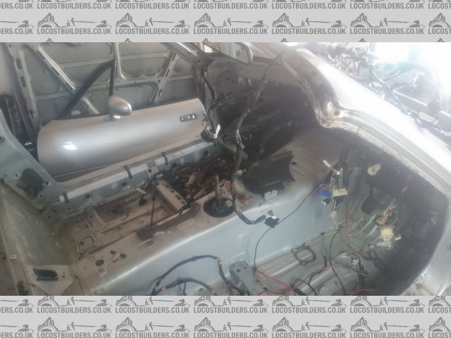

Got an afternoon on the car today, and the Destruction Manual had arrived, so I got to work.
DestructionManual
Wasn't too long before my 2-door car became zero-door without bonnet and boot too.
ZeroDoor
Getting topless
NoTop
Wiring everything, even circuits I won't be using just so I know they're safe to remove.
WiringLabels

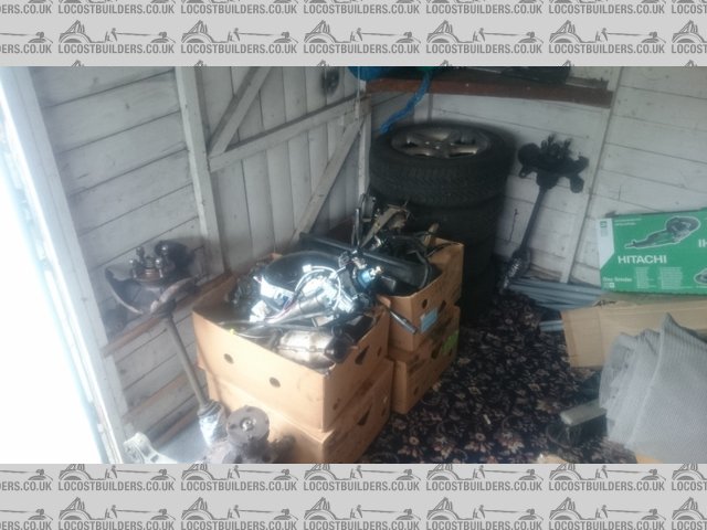

Bloody good job it's a big garage, the junk piles keep growing. Thankfully I have a backup shed behind the garage to act as a holding area.
JunkPile1
JunkPile2
Feels so good to have got started properly

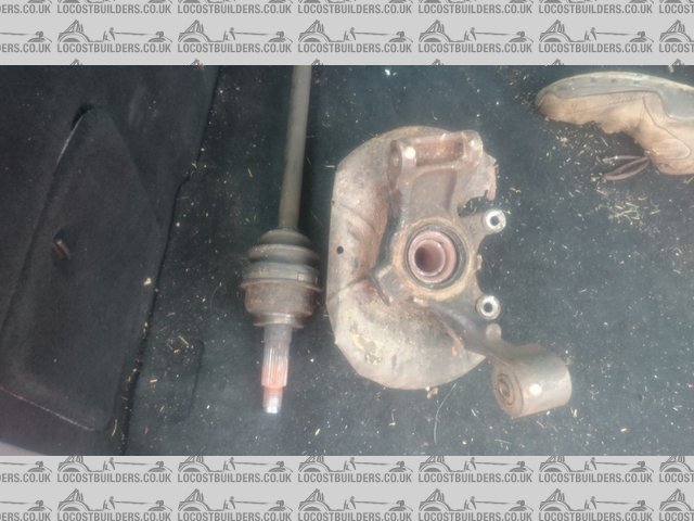

And today, scored a big victory. I've been fearing the rear hub nuts for ages with stories of split sockets, bent breaker bars and jumping on
scaffolding poles for leverage. My 1 1/8" impact socket arrived today, so I bit the bullet and gave it a go with my battery-powered impact
wrench. Was rather disappointed that it only took 5 seconds a side, I expected more of a fight. I've temporarily refitted the hub nuts so I can
roll the car about still, but at least I can make a start on the brakes now I don't need them to counter-hold against the hub nut.
More to follow Friday
Haha getting the hub nuts loose is the easy bit, wait til you try and get the shafts out and the wishbone bolts out, they really are fun

I had heard that part was fun, stories of cracked carriers when using a hydraulic press. At least that should provide some interest.

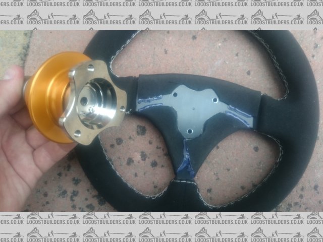

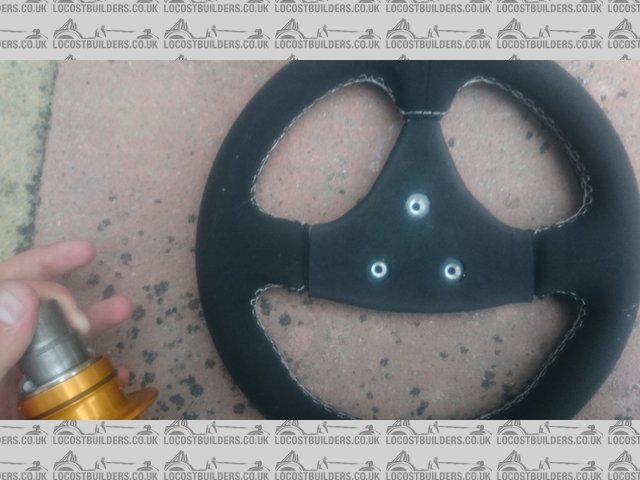

More happy progress today, didn't have enough time to get dirty, so I thought I'd tackle the steering wheel instead. I was a bit nervous
about this, particularly since the Rapfix gets in the way of marking holes straight through it. After a bit of thinking, I drew up a template in
Powerpoint at a PCD of 50.8 mm and with vertices spaced at 120 degrees. I stabbed a pencil through the centre of the template to engage with the
dimple on the steering wheel, and centre-punched at the vertices. I'm pleased to report that it was absolutely spot on, not a single hole had to
be enlarged for any mis-measurement
PerfectlyDrilled

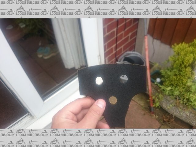

Now, after my oversight on the IVA requirements for the padded steering wheel, I bought Pack of: 5 x Self Adhesive Peel Off - Black
Foam Sheets 175mm x 135mm x 3mm. At first I tried cutting a rough shape first just to apply to the front face of the wheel, however, it looked
awful and peeled off too easily, which would upset Mr IVA. The holes were cut using a socket and a hammer
PadPrototype
I decided that it would be better to wrap the sheets around the back of the wheel to give a better fit. As luck would have it, the sheets were
perfectly the right width, so I cut my holes again, peeled off the backing, and this time, folded around the back of the wheel, trimming to fit where
necessary.
PadRear
And finally, I fitted it all to my quick-release boss. I might have another attempt at the foam covering, try to get the holes centred on the bolts,
but all-in-all, not a bad attempt for the second try.
WorksBellFitted
[Edited on 3/7/2015 by micksalt]
For information, you need a stronger glue to do the DIY pad that I've demonstrated. The glue sticks to the steering wheel alright, but the
neoprene itself peels from the glue where I've wrapped it around the back. I'll take the opportunity to make a slightly better job on the
holes positions, and use a hot-melt glue gun next time.

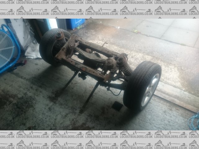

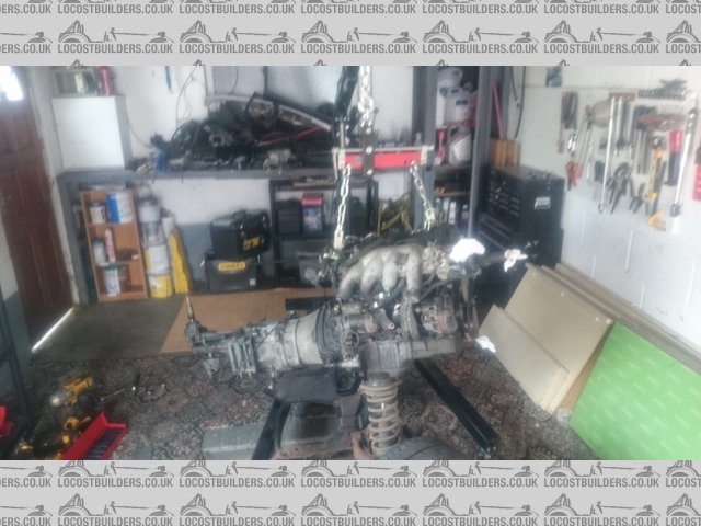

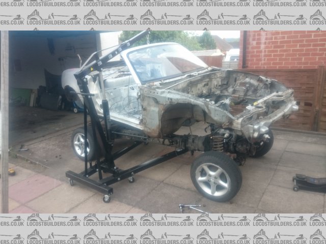

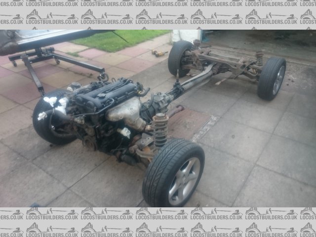

Will upload some photos later, but I am finally ready to lift the body off. Next session, assuming dry weather, the MX5 is going topless.
Finally, we have lift-off, so glad my mother convinced me to go for the 2 ton crane over the 1 ton, I'd missed two 14 mm head bolts at the front,
and another two at the back, so ended up lifting the car
LiftOff

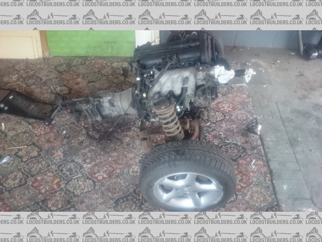

Now we're down to the rolling subframe, disassembly should come along nicely, and I can put the daily driver away. That is after I've
cleared the junk pile into stuff to use, stuff for sale, stuff for weighing in and stuff to bin. Any MX-5 owners looking for an obscure part that they
know I won't be using, shout up now.
RollingSubframe

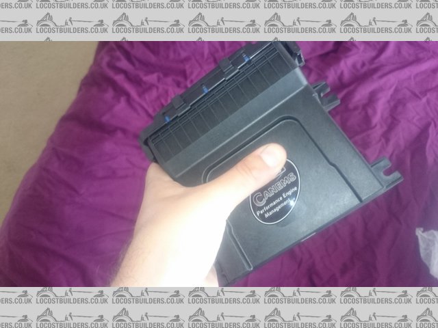

She'd be even less impressed about my other purchase. Again, shhhh, doesn't count to the budget I declared to her
Canems

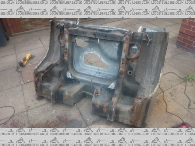

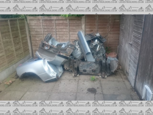

Shell is getting in the way of the washing line, tomorrow's job is cutting it up.
Progress was rubbish on the shell cut up. A 5" battery powered grinder is definitely not the way to go
SlowCut
Haha. 9" angry grinder is the way to go.

Having got myself a 2000 watt, 9" grinder, today's task was to finish cutting up the shell. Unfortunately, rain stopped play, so I turned my
attention to the rolling sub-frame assembly. Not quite as easy as I'd hoped, but I overcame the issues. One curious thing is that because the
bolts are so long, the spring tension of the bolt makes the impact gun pretty useless, 2' breaker bar it was then
However, the front bolt of
the diff-to-PPF came undone from its threads alright, but got jammed trying to take it out. on further inspection, the lower diff spacer was actually
cracked, and the bolt had seized itself to it where the water had got in. Took a little thinking, but I undid the connections to the PPF at the front
first and then removed the prop-shaft. I could then put the assembly on end and angle-grind through the cracked spacer whilst causing no damage to the
PPF. After all that fun, I ended up with these.
FrontSub
RearSub

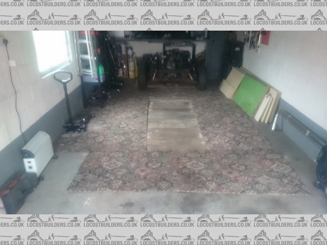

After moving the junk pile into the back shed, I created a SWB MX-5 in the garage.
ShortWheelbase
Finally, I have a usable garage again. I took the opportunity to cut the carpet around my inspection pit to save the faff of rolling it up each
time.
TidyGarage

Anyway, the rest of the project is going well. The body took no time at all with the addition of a 9" grinder
FinalCut
Leading to a self-assembly MX-5 body kit.
SelfAssemblyMX5
Crucially giving me a clear patio. Needs a good clean though after all the rust that fell off the donor. I've done the fellowship of the road a

And it was a very productive afternoon, got the engine and gearbox assembly free from the sub-frame pretty easily once I'd figured out how to
attach my load leveller to it all.
FlyingEngine

Hands up if anybody can guess what problem I've currently run into.
DriveshaftRemoval
Annoyingly, the other driveshaft popped out with not much of a fight using a hub puller and impact wrench, and that was a little more corroded around
the hub nut due to the absence of the dust cover. I'm going to need a new CV joint on the end of this driveshaft at the very least because I was

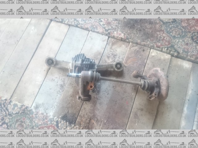

Well, here's the heavy-duty jig used to separate the hub from the driveshaft, using the biggest oxy acetylene torch we could find:
BigJig
And the happy outcome:
FinallySplit
I had an evening of keeping clean last week, so I turned my attention to finally sorting the steering wheel padding. The prefabricated pad I ordered
was the wrong shape, so back to my neoprene wrap. This time, I wrapped further around the wheel, cutting around the Rapfix to maximise the sticking
surface. Having had some practice with the hot-melt glue gun, I was able to make a much neater job of securing the edges. Pleased to say, this one
didn't peel back
PaddedWheel
IVAFriendly

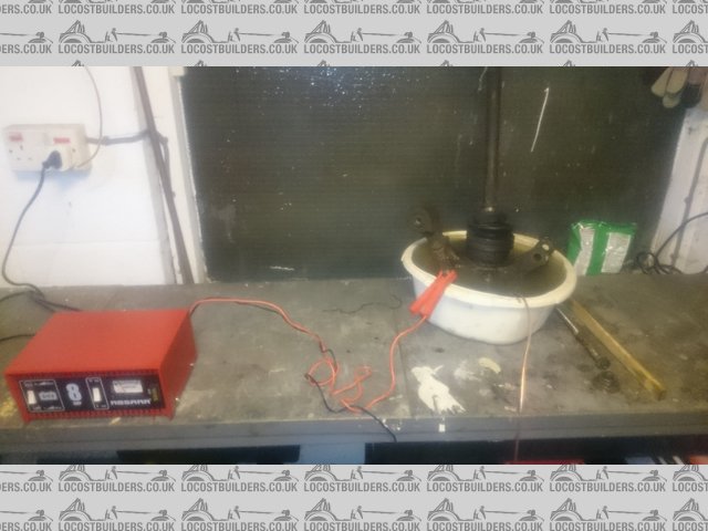

Whilst I do have electrolysis equipment handy, for the small items it was just as easy to use the wire brush in the angry grinder.
Cleaning

In anticipation of the new arrival, I decided to get the engine and gearbox split so I could put them somewhere sensible. Also, I'd rather not
trip and impale myself on the gearstick.
Engine
Engine is due a clean, paint, new timing belt kit and clutch.
Gearbox
Gearbox just needs a clean, turret seal renewing and filling up with gearbox oil too. I can see why the MX-5 is becoming a popular donor choice, that
gearbox is ridiculously light.

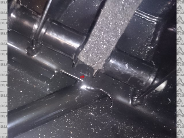

The only snag was that I'd positioned the
chassis with the front facing the garage entrance, and the engine and engine crane were behind it. Ended up having to drag the engine along the carpet
to the correct end of the car, Doh! Here's the problem I have, in the original Mazda pedal box that I photographed, the pedal was offset to the left, giving plenty of room to put
the stop-bolt in:
OldMazdaPedalBox
Probably in response to feedback that the brake and clutch master cylinders were too close together, the Mazda brake pedal has been updated to a more
central position. The only problem with this is that the chassis tube now prevents the use of a bolt-stop. I have confirmed with Marc that this is an
updated pedal design rather than a case of the wrong pedal being sent.
NewMazdaPedalBox

Is your pedal box welded to the chassis ? It looks like it is in your pic
It is indeed welded to the chassis. I've noticed quite a few detail changes compared to the car I took reference photos from.

Finally, I could fix the main tub. I took Leon's advice and glued it using Tiger Seal. Bit of a pain to remove if I need to, but it saves
drilling any extra holes in the chassis.
TigerSeal
