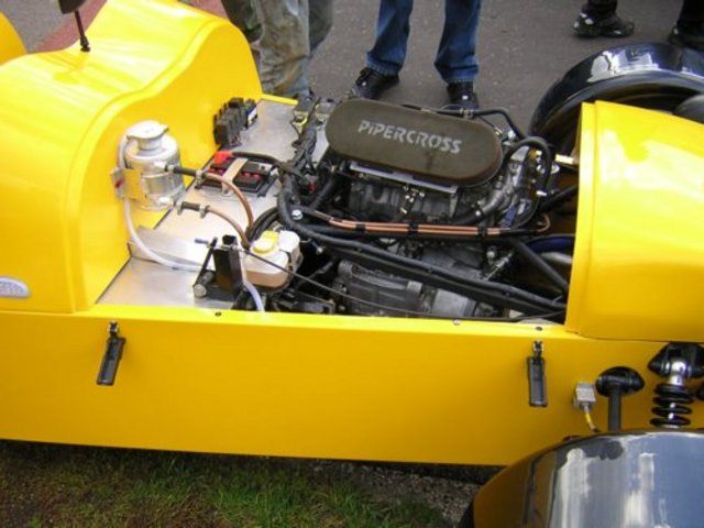

andy d (rizla)
| posted on 9/8/05 at 06:12 PM |
mines here
smart51
| posted on 13/8/05 at 01:12 PM |
header tank on the GRP scuttle seems a good idea but the aluminium plate underneath is covered with electrcal things on my car. teh tank will have to
go over the ECU and the pipes out of the tank would be right over the ECU connectors. Will SVA man object to this?
