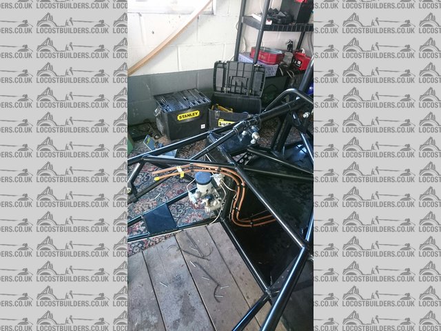

Well, it all became more obvious one I trial-fitted. The fuel pump does indeed go on the side shown in the manual. Once I laid it all out, I realised
it was the only way that the pre-pump filter fitted properly.
  FuelFront
  FuelTunnel
  FuelPump
The rivnuts for the fuel pump proved interesting, The instructions for the tool explained how to install the rivnut, not how to remove the tool. Had a
tool stuck to my chassis for a while whilst I figured out how it actually came off.

Quick point, your brake pipes seem to run over the gearbox mount point in the centre tunnel? I had to stack mine vertically at the side of the mount
plate.
Stu
micksalt
| posted on 5/10/16 at 08:41 AM |
I had forgotten to check where the gearbox mount point goes. Should hopefully be enough flex for me to mount them vertically as you suggest. Thanks
for the heads-up.

micksalt
| posted on 9/10/16 at 04:07 PM |
  FuelPipeReRoute
Thanks Stu and Jim, that could have been a lot of rework without your help.
l5tuy
| posted on 9/10/16 at 08:35 PM |
No bother, looking good now.

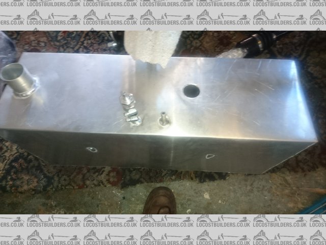

| posted on 28/3/17 at 03:21 PM |
Been ages since an update.
First up was the fuel level sender, which was a bit long for the tank. Whilst this soldering isn't pretty, I've given it a good bash and a
pull to make sure it was solid.
  SolderLevel
Next up was to cut a hole in the tank. I had the worst hole-saw that pretty much ground the hole out rather than cutting it. Thankfully, it
didn't have to be too precise.
  RoughHoleSaw
And it fits! I connected up my multimeter and turned the tank upside down to check that I had the full movement range.
  SenderInstalled
