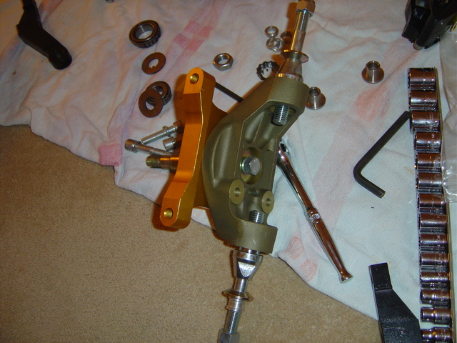

marc n
| posted on 17/12/08 at 01:36 PM |
hi all
appologies for delay, im not getting much time to web surf at the moment, if the uprights have come from us directly safety washers are supplied, or
should have been, if they previously came from raceleda / rally design the pins are not long enough to incorporate a safety washer as pictured and a
high angle spacer, and fitting just the safety washer will create lockout. so large thinner washers have been supplied by us.In the build manual it
does state the use of safety washers. however at some svas they have failed the radius check and have been removed, and maybe have not been
refitted
i would urge those affected / not sure etc including matts friend to contact me direct by email with pictures to make sure which setup you have and
the correct fitments and applications so we can send the appropriate parts asap
please see pic below that somone posted last week showing a rally design upright with our pins / safety washers / spacers
best regards
marc

Richard Quinn
| posted on 17/12/08 at 06:53 PM |
The short answer is that I don't know. This is a set up that has been making its way from track to road cars and is still not that widespread.
Failures are quite well known in track situations hence the development of the safety washer which is now pretty well known and accepted in
motorsport.
As you are aware, the SVA isn't the best assessment of a vehicle's overall safety with the bias towards the safety of people outside of
the vehicle rather than those in it. Safety washers would just be another sharp edge issue on the current SVA.
At the end of the day, it is entirely up to people running rose jointed front corners whether they want to fit them or not. As I suggested above,
there should be a duty-of-care to provide the appropriate safety related items but it would ultimately be up to the individual end user as to whether
they choose to fit them.
