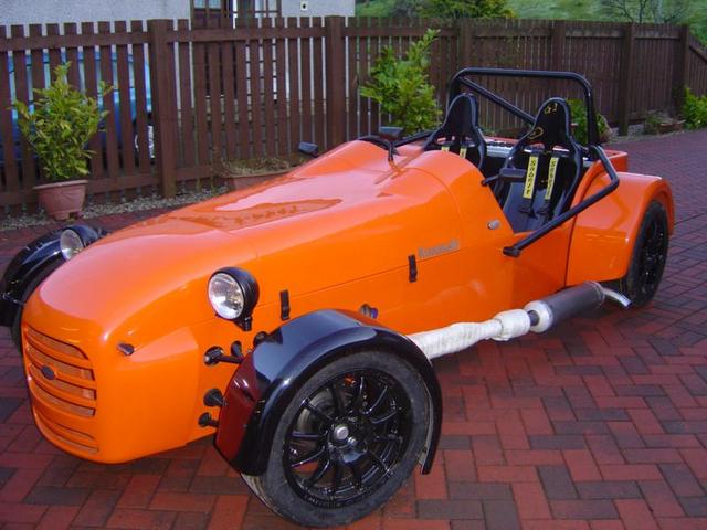

just thought i would post a few pictures of my hard work.

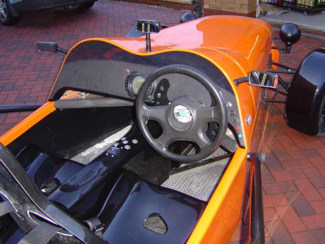

Looks good.
Front indicators look to be too far in from the widest part of the car (prob' rear wings). They should be no more than 400mm (IIRC) max from the
outside edge.

Where is your hand brake ?
The car looks very nice
Good luck with the SVA
Jacko
mitch2b
| posted on 18/1/09 at 07:19 PM |
Its the switch, hes gone posh and used an electric one again

Well done it looks great, just a few points that will fail SVA
Cycle wings will need u-trim around as there is no return edge, Indicators are too far in from widest part of car & are those mirrors E marked as
they look like racetech & if so will fail the radius test.

As stated in other posts mirrors, indicators and edge trim on front arches need to be addressed.
I like the idea of the electric hand brake. Can you post up some detials.
I have a centre for the steering wheel if you haven't got one. If you want it U2U me your address and I'll send it tomorrow first class so
you should get it in time.
ETA: Good luck for Wednesday.
[Edited on 18/1/09 by stuart_g]
stevebubs
| posted on 18/1/09 at 10:03 PM |
Have you spoken to your SVA centre about the
electric brake?

| posted on 19/1/09 at 01:14 AM |
my last car had this at sva aswell,no probs with it then.

Just a quickie. You worried about the radiusing on the bike clocks? Are they outside the exclusion zone of the Sierra wheel?
I'm wondering as mine are a similar distance away from the wheel and not radiused...
