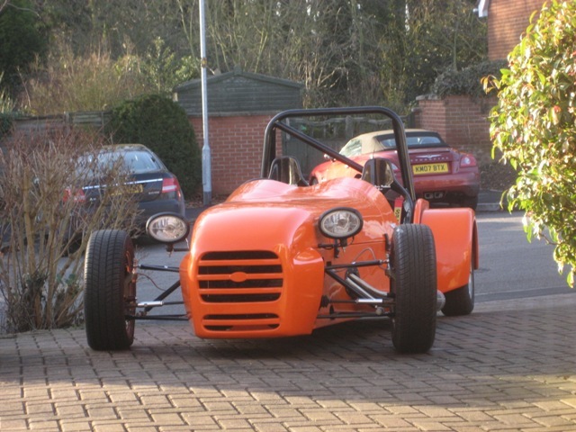

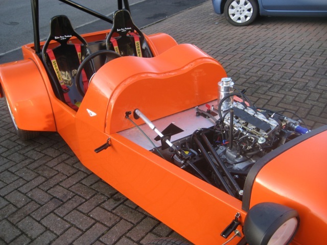

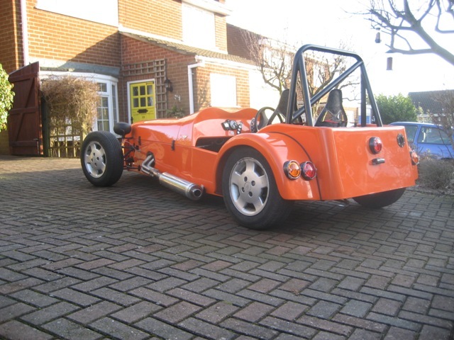

well after solid weekends it scince the new year i have a car which looks like a car and is almost functional (brakes just need re bleeding and
throttle and cluch pedal returns need sorting out.
what i need to know is what extras i need for the SVA some pics of Vortx's in SVA trim would be good.
Im hoping to get a CAT and front bars off MNR but what trim do i need? I have identified the ares below what have you guys used for these?
1. Nut covers (i have these at least )
2. Trim for arround the suspension holes at the front?
3. Covers on the steering arms? Where do i get them from?
4. Some sort of cover for the bars undr the shuttle what have people used for this?
5. Need to make a boot cover
Many thanks in advance
A few pics:
  front update
  cockpit
  rear
  engine
[Edited on 27/1/09 by Pdlewis]

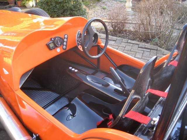

| posted on 27/1/09 at 02:56 PM |
looks awesome but im intrigued, what do the three buttons on the tunnel do?
Pdlewis
| posted on 27/1/09 at 03:07 PM |
Full beam at the front
then left indicator
then right indicator
Build Photo Album
Updated 05/02/2009
stuart_g
| posted on 27/1/09 at 03:23 PM |
Looks good, need to ditch those wheels ASAP though!
Answer to you q's
1, yes fit them
2, not needed
3, goto an electrical wholesalers and ask for cable gland covers (25mm dia)
4, not needed but you can fit central heating pipe lagging if you want.
5, Definately fit
I would also fit edge trim to the seats and harness holes, also edge trim on the triangular harness plates and nut cover on the harness bolts.
I have a picture of mine fitted with the MNR loan equpment I will post later.
[Edited on 27/1/09 by stuart_g]
