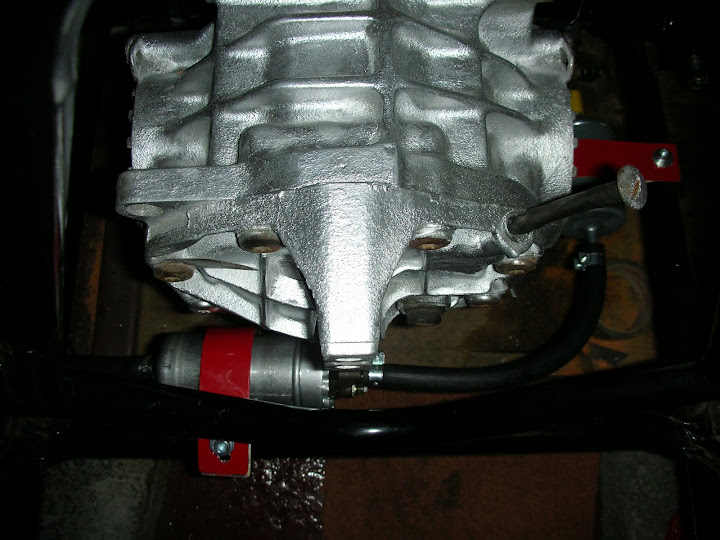

| posted on 18/5/09 at 04:58 PM |
Not the best picture but i have my pump fitted behind the diff
Build Photo Album
Updated 05/02/2009

| posted on 18/5/09 at 05:08 PM |
pump is near diff under the tank - ish
filter is in engine bay
now if i did it again then i'd filter it before the pump and then a 1 way filter valve in the engine bay
stops that annoying pump going to fill the pipe and then the filter before i can think of starting it
Time for a change!
| posted on 18/5/09 at 05:29 PM |
and stops crap getting in the pump too
